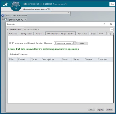

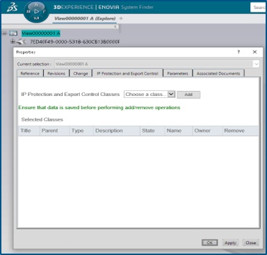

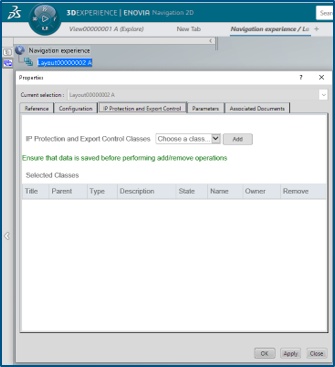

You can now assign IP Security Classes to the following types of object:
  • DIF Layout
  • DIF View
  • DIF Sheet object
To support that, a new tab ‘IP Protection and Export Control’ is introduced, available in the objects properties panel in native apps.

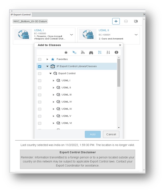

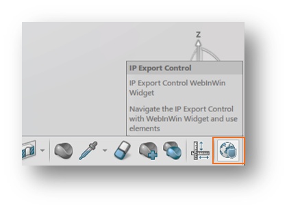

‘IP Export Control’ command is now available in Tools section in Native apps.
This command allows you to:
  • Assign or un-assign objects to IP Security classes in 3DEXPERIENCE CATIA.
  • Display the Physical Location.
