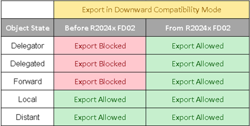

Export in Downward Compatibility Mode: Support for Delegated Objects
Why
Improved efficiency thanks to the ability to consider delegated objects while exporting in downward compatibility mode
How
  • In the downward compatibility mode, you can now export or import objects that are involved in a delegation process.
  • With this enhancement, while exporting objects in the downward compatibility mode, the following object states are also supported:
  • Delegator
  • Delegated
  • Forward
