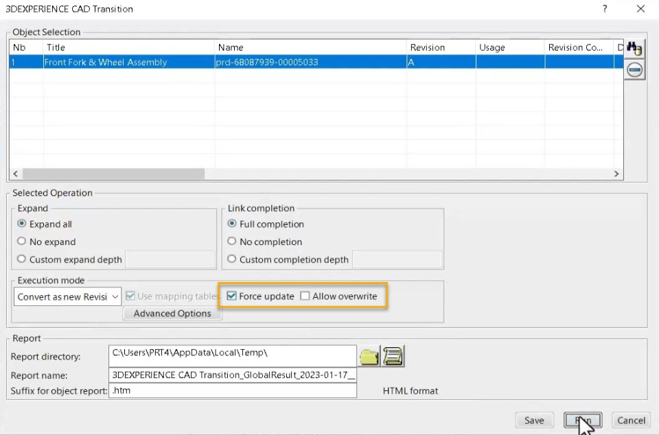

 3DEXPERIENCE CAD Transition Utility: Updating Converted Objects
Why
Easily reflect modifications made in the native CAD by updating converted objects multiple times.
How
This enhancement is useful when native CAD objects are saved in the platform and converted into the 3DEXPERIENCE objects using the utility but some medications are made later into the native CAD data. In order to reflect these, you can save this modifications in the platform and re-run the utility with the new “Force Update” and “Allow Overwrite” options.
  • The “Force Update” option allows you to carry-forward this modifications in the new revision if the “Convert as New Revision” execution mode is selected.
  • If along-with the native CAD data, even the converted 3DEXPERIENCE objects are modified, then you can use the “Allow Overwrite” option to overwrite the native CAD modifications over the modified 3DEXPERIENCE objects
