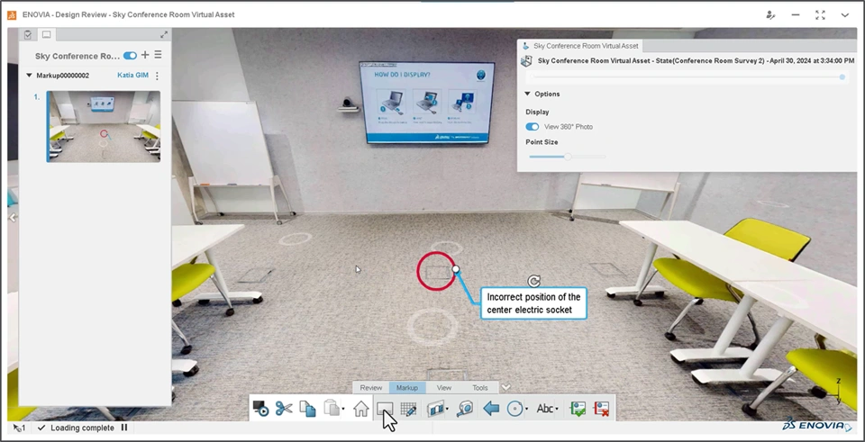

Review Support for the Location States
Why
Improved review scope through support of reviewing location states representing point cloud data
How
  • You can now open and review the Location States in the Design Review or Design Validation apps.
The Location State allows you to visualize your Real-to-Virtual (R2V) data in form of Photo 360° or Point Cloud representation.

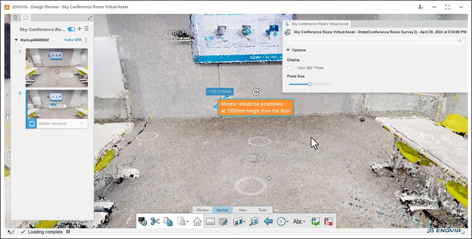

  • You can use the toggle button to switch between the Photo 360° or Point Cloud representation
  • While reviewing the Photo 360°, you can use the text or other markers to highlight concerns. While reviewing the Point Cloud representation, you can also use the measure tool.

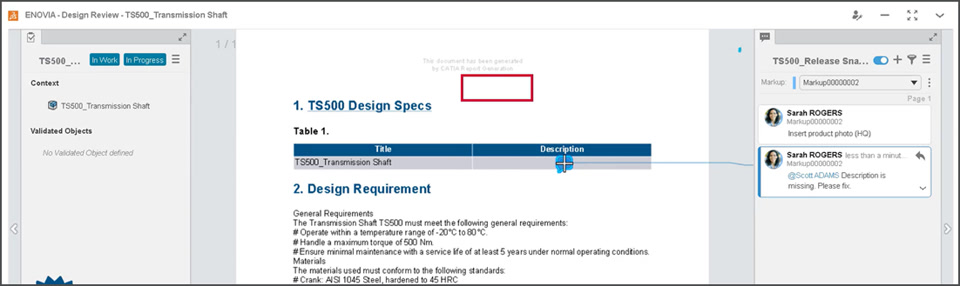

Review Support for the Release Snapshot
Why
Improved review scope through support of reviewing release snapshot of the product
How
  • You can now open and review the Release Snapshot in the Design Review or Design Validation apps.

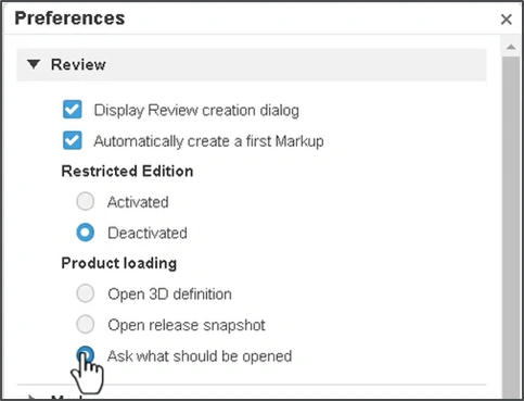

Pre-requisite: A Release Snapshot is created for the product using Specification Manager role.

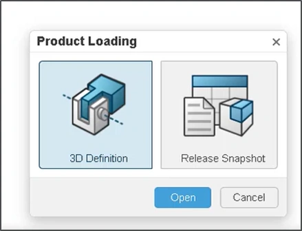

  • From the Review Preferences dialog box, you can also decide on the loading behavior while opening a product that has Release Snapshot attached to it.
  • When you choose "Ask What Should be Opened" in the preferences, you can decide whether to review the product or the associated release snapshot when you open it.
