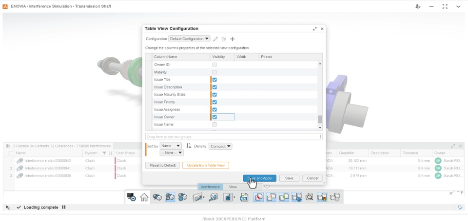

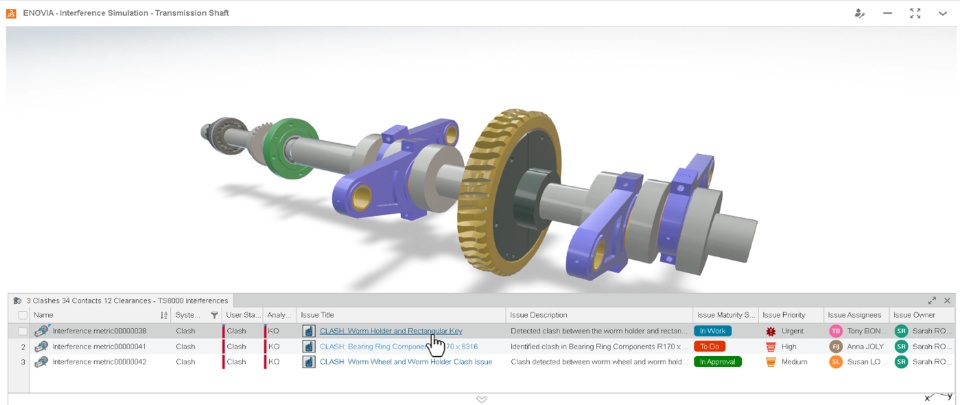

Display Issue Attributes In Interference Table
Why
Quickly obtain details of the issue connected with the interference metric using table view configuration
How
  • You can now add the Issue Attributes using the Table View Configuration to display details of the issue associated with corresponding interference metric.
  • While viewing interferences in table view, you can also click on the Issue Title to open it in the transient Issue Management app.

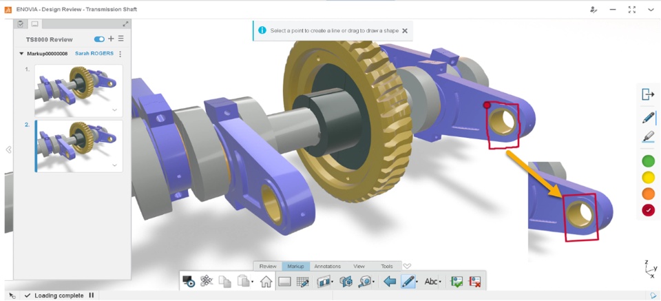

Free-hand Shape Recognition and Cloud-shaped Marker
Why
Improved speed while creating free-hand annotation thanks to its automatic shape recognition
How
  • The free-hand annotation experience is enhanced to enable automatic shape recognition.
  • When you draw a geometric shape using free-hand annotation, the system detects and optimizes its shape for a more precise appearance.
  • Auto-recognition is supported for the following types of shapes drawn using free-hand annotations:
    • Circles
    • Ellipses
    • Rectangles
    • Straight lines and Splines
  • You can now also use the cloud-shaped markers to highlight specific issues during review.

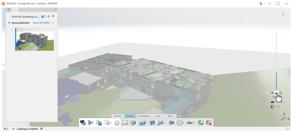

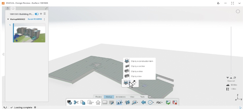

Section-view option: Clipping By a Construction Item
Why
Improved efficiency while reviewing Site or Building objects using the ‘Clipping By a Construction Item’ section-view option
How
  • You can now use the new "Clip By a Construction Item" option while taking a sectional view. This option is available and selected by-default only while reviewing the Site or Building objects.
  • This allows you to accurately position the sectional plane on a specific floor using scroll bar or up/down arrow keys

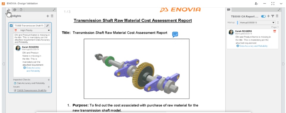

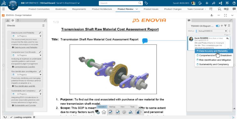

Referencing Validation Checks in Comments
Why
Improved traceability thanks to the ability of referencing checks in review comments
How
  • While reviewing documents, you can now append the ‘check’ to the review comment/reply
  • Also, when you create an issue on comment containing check, the following things happen:
    • Highlight is automatically created and connected with comment and appended check
    • Highlight priority is set to the priority of the created issue
    • You can select a comment to spotlight associated highlight and find it easily
