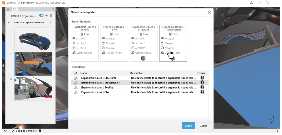

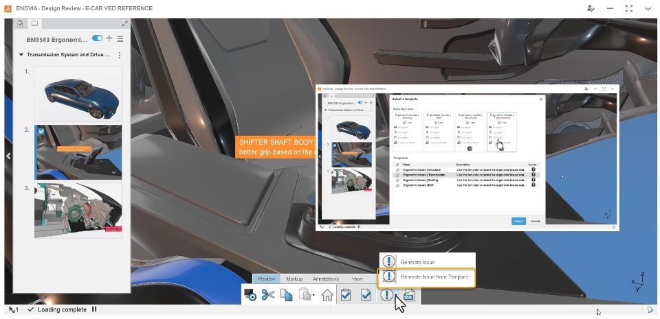

Why
Save time by using the predefined issue template while raising issue in the Design Review app
How
  • You can now use the new “Generate Issue from Template” option in the Review tab of the Design Review app.
  • This allows you to select the predefined issue template from the list and use it to raise the issue.
  • All the details from the template are carried-forward. You can update them as required and raise new issue on-the-fly.
This functionality is also available in the Design Validation app of the Digital Mockup Validation Manager [YED] role.

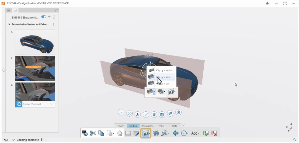

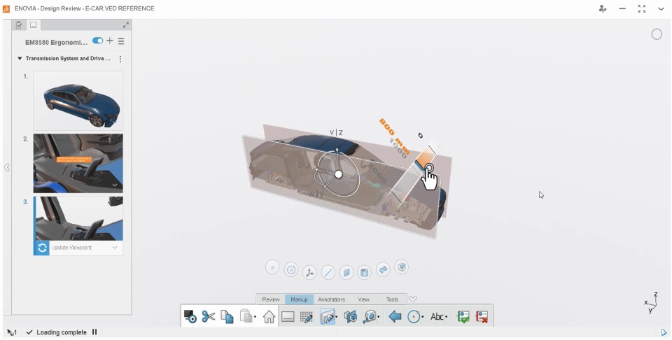

New Clipping Tool
Why
Improved review productivity by easily visualizing and reviewing internal parts of the product
How
  • You can now use the new clipping feature to visualize the relevant parts of the product.
  • For this, the new “Activate Clipping” option is provided in the Review tab of the Design Review app. This provides you following three options to position your clipping planes:
    • Clip by a Section: Lets you position one sectional planes to view elements located on one side of it.
    • Clip by a Slice: Result displays elements located inside the two parallel planes.
    • Clip by a Box: Result displays elements located inside the positioned box.

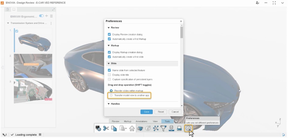

Transfer the 3D Viewpoint to Native Apps
Why
Faster issue resolution by easily transferring 3D viewpoint from Design Review slides to native design apps
How
  • You can now drag-and-drop slide view from Design Review app into the native app (For example: Product Structure Design) to quickly visualize the selected viewpoint and fix the issue.
  • To enable this transfer of viewpoint from dashboard app, you can select the “Transfer Model View to Another app“ check box in the Design Review app preferences.
