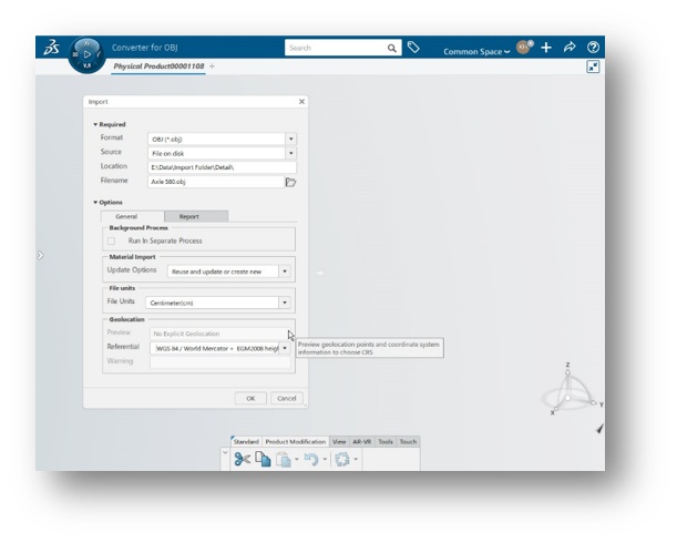

Coordinate Reference System Chooser (FOL FOB FOO)
Why
Improve the accuracy of imported data by employing a specific reference system for the coordinated data during import
How
  • User can now choose a specific Coordinate Reference System (CRS) on import so that the data is properly geo-located.
Note:
FBX, OBJ, and COLLADA files do not contain geolocation information so this information must be defined explicitly in the system for such imports.

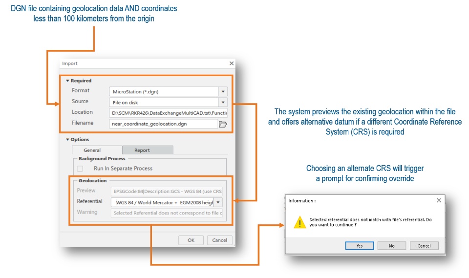

Manage Geolocation Data (FOM - Conversion Data Integrator for MicroStation)
Why
Increase flexibility during data import when working with designs containing geolocation information
How
  • You can now import a file that contains geolocation information (degree, minutes, seconds).
  • Import MicroStation design models (.DGN) to allow the user to translate them by defining a new geolocation or using the existing one if included in the file.
  • If the file coordinates greater than 100KM from the origin, the information can be translated locally to simplify the coordinate definitions.
