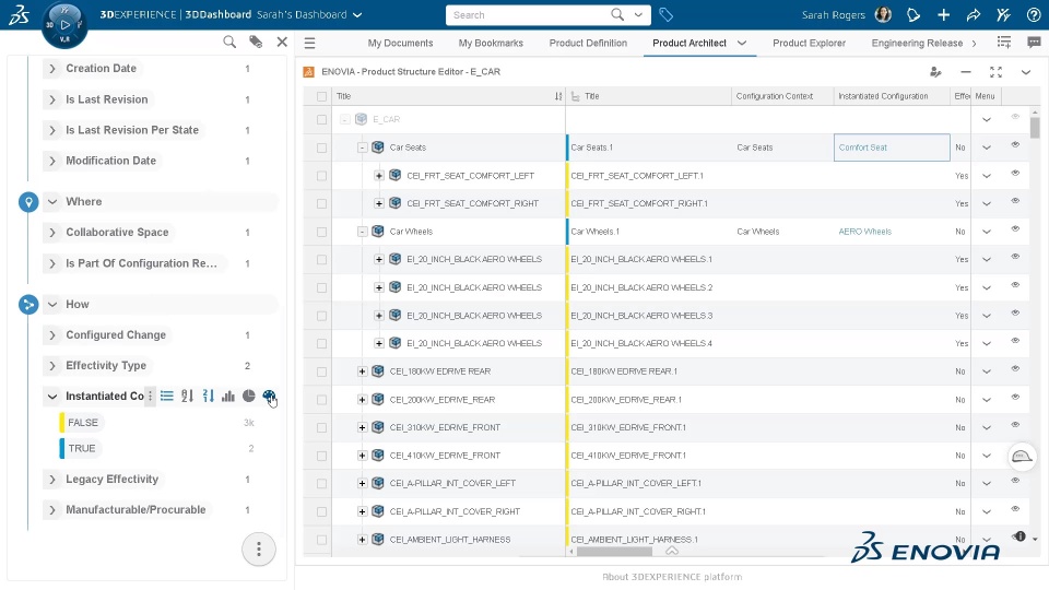

 Recognize the Instantiated Product Configurations in the Product Structure Tree
Why
Easily recognize the product configurations inserted in the product structure tree by using the new 6WTag “Instantiated Configuration”
How
  • You can now use the new “Instantiated Configuration” 6WTag to filter and color the instantiated product configurations in the product structure tree.
  • The new “Instantiated Configuration” 6WTag has following two values:
    • TRUE: Result shows the product structure with the instantiated product configurations
    • FALSE: Result shows the product structure without the instantiated product configurations
  • You can use the Colorize option in the 6WTags to colorize the instantiated product configuration in the product structure tree and easily recognize them.
  • You can also insert a new column that shows the related Product Configuration name. To do this, you can open the “Tree list view options” and add the attribute column by selecting the checkbox for the “Instantiated Configuration” attribute.
