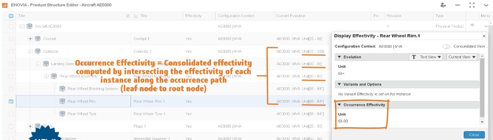

Display Occurrence Effectivity of the Configured Instance in the Multi-level Structures
Why
Improved traceability by viewing occurrence effectivity of any instance in the multilevel structure
How
  • A new “Display Effectivity” option is provided in the Configuration tab of the Product Structure Editor app.
  • This option displays the following tabs for the selected instance:
    • Evolution: Displays Model Version and/or Units Evolution Effectivity of the selected instance
    • Variants and Option: Displays variant and options effectivity of the selected instance
    • Occurrence Effectivity: Displays the consolidated effectivity computed by intersecting the effectivity of each instance along with occurrence path.
Note: The “Occurrence Effectivity” is only available when value of "isOccurrenceEnabled is set to True in the following file:
/home/data/RTV//apache-tomcat/webapps/3DSpace/webapps/CfgBaseUX/assets/CfgUXEnvVariables.json
Note: The Occurrence Effectivity” tab is only available in the On Premise environment after updating the JSON file as mentioned above.
