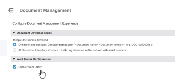

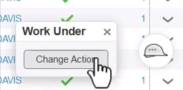

Work Under Support for Documents
Why
Track changes made on documents
How
•You can now use the Work Under a Change Action for Documents.
•The admin setting “Enable Work Under”  should be selected (Document Management à Work Under Configuration: Enable Work Under):
•The “Change Required should be turned on for the document.
•The following actions will be captured when working under a Change Action for a Document:
•Change Status(Promote/Demote)
•Properties Modification
•Revise
•Document Creation
•Document Deletion
•File add, delete, modify.
•The changes captured by the Change Action are available in the “Realized Changes”

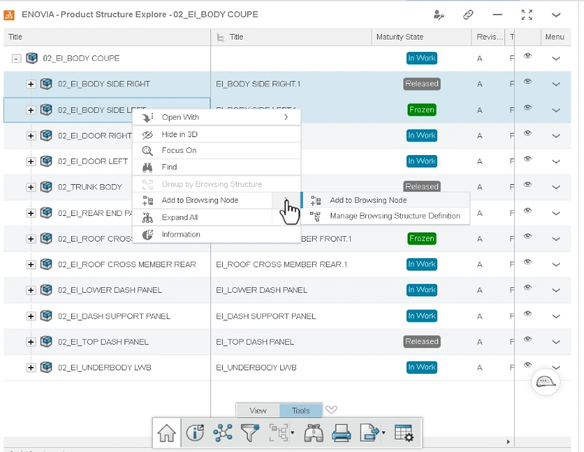

Product Explore: Browsing Structure Support
Why
Improved product structure navigation experience by organizing product definition using browsing structure nodes
How
  • You can now assign Engineering Items to predefined nodes (*) and display them in groups that reflect these assignments.
  • This facilitates the navigation of your Engineering Definition. A new command “Manage Browsing Structure Definition” is available now, to enable you to:
    • Group Engineering Items by a Browsing Structure
    • Add the selected Item(s) to a Browsing Node.
    • Review an existing assignment, and modify it (adding / remove nodes).
Notes:
  • Browsing Structures and Browsing Nodes are created with “ENOVIA - Browsing Structure Definition” App (Role: CCM - Classification Manager)
  • The Browsing Structure must be released to be able to use its nodes in the association with the Engineering Item.

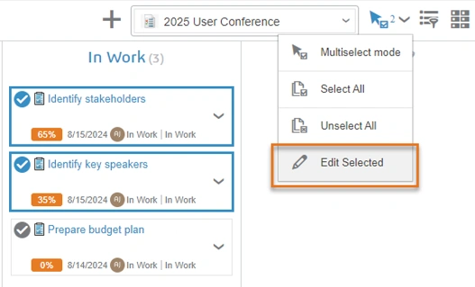

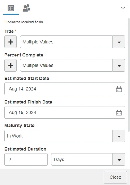

Mass Edit
Why
Save time by performing mass edit for selected tasks.
How
•You can now apply the same change across multiple Project Management tasks.
•The supported fields are:
•Title
•Percent Complete
•Estimated Start & Estimated Finish Dates
•Maturity State
•Estimated Duration

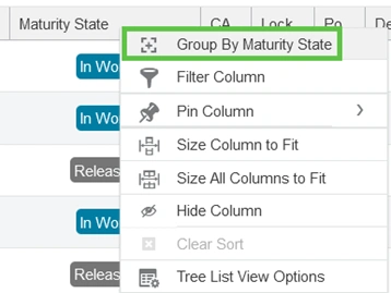

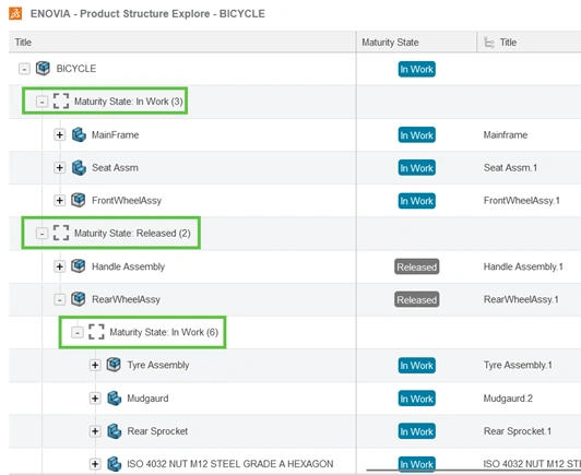

Group by Column ( Product Structure Explore app )
Why
Improve productivity while working with product tree view by grouping rows based on their values.
How
  • A new command “Group by the column” is now available from the header of each column
  • This command will group the product structure according to the selected value in this column.
