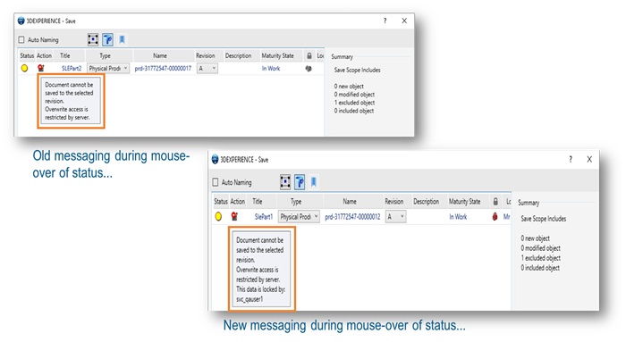

Improved Error Messaging During Save
Why
Improved user experience on save through more accurate error messaging
How
The error message on “Save” has now been improved to be more accurate.
Situations where the error messaging has been improved:
  • Object locked by other user. The user is now identified.
  • Object associated with the wrong “Change Action” during the Save operation. Correct Change Action is now shown in message.

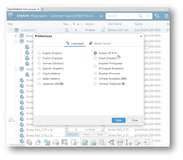

Expanded Language Support
Why
Improved flexibility in worldwide deployments through broader support of international languages
How
You can now use one of the additional supported languages within the AutoCAD integration:
  • Czech
  • Polish
  • Korean
  • Traditional Chinese
