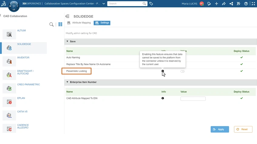

Optimistic / Pessimistic Locking |
Why Reduce the occurrences of overwritten data by enforcing user locks during edits of parts and assemblies |
How You can now activate the ability to prevent the saving of parts and assemblies if they are not locked by the current user (Pessimistic Locking) By default, parts and assemblies are excluded from save scope if they are not locked The Save prompt will allow you to Lock and Include the parts and assemblies in the current Save operation to streamline the use of the new capability |

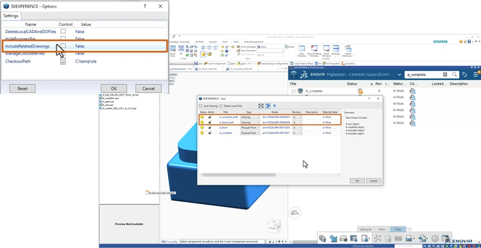

Include Related Drawings on Save |
Why Manage related draft drawings developed during the design process through automatic save to the platform |
How You will now be able to automate the save of related drawings of the children of top-assemblies into the 3DEXPERIENCE platform |

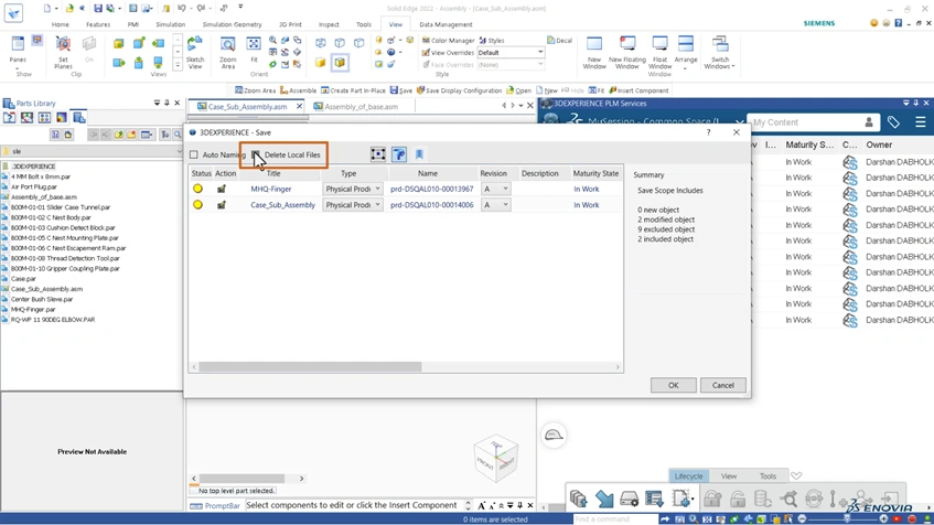

Delete Local files on Check In |
Why Remove checked in data on save from the checkout directory improving your ability to retain needed file space and protect valuable data |
How You can now use the option Delete Local Files during the Save operation to automatically remove the files being saved from your check in directory (cache) Files that are used by other assembles in your check in directory will not be removed |

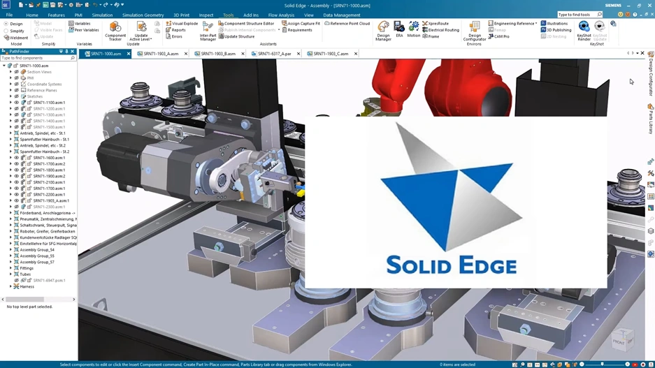

Support for New CAD Release |
Why Enhanced usability through extended CAD version support |
How Support has been added for the Solid Edge 2024 release |
