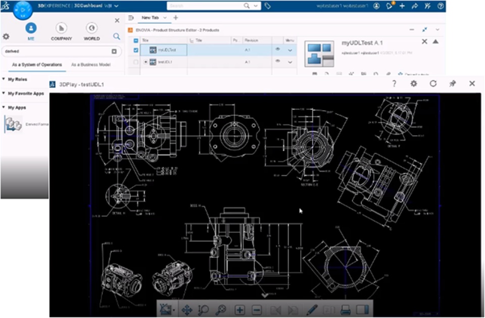

UDL Generation from DWG
Why
Streamline creation of UDL data during the saving of drawings to the platform
How
•The generation of the UDL data format pf the drawing will now be automatically requested at the time of check-in of drawing.
•The operation is based on the Server Based Derived Output rules. In the administrator console
Note that UDL is the “Unified Drawing Light” format which is the DS format for 2D visualization of drawings. 3D Play and 3D Markup are capable of reading this format and rendering the corresponding web views

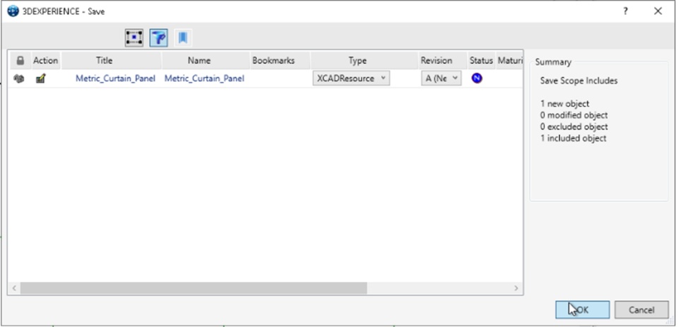

Save and Insert Revit Families
Why
Manage Revit Families (RFAs) on the platform to provide a managed catalog of components across projects
How
•You can now save RFAs to the platform an then instance the managed RFAs into a Revit central file
•The insertion of the selected Revit family while automatically be placed at the proper location in the Revit project browser structure.

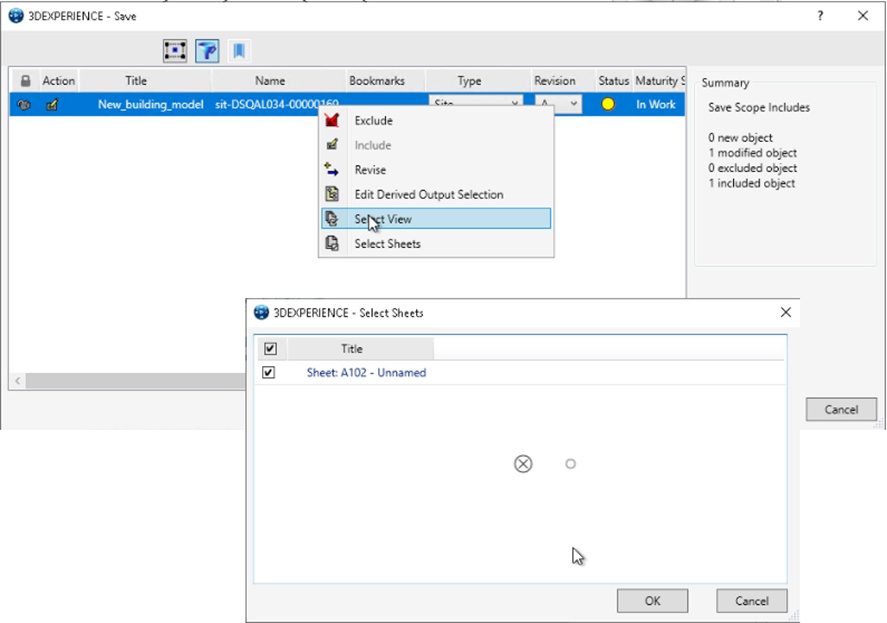

Expose Relevant Sheets on Save
Why
Save specific sheets from the project during the Save operation to streamline the availability of such data to the “common data environment”
How
•During the Save operation of the central file, you can now save one of more of the drawing sheets associated to the project into the common data environment of Revit
