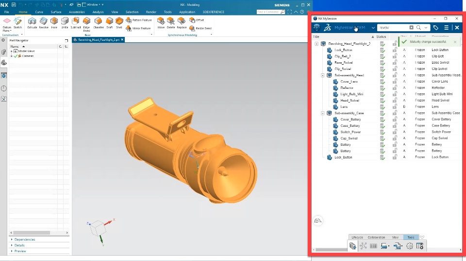

Note: All of the enhancements covered in this release are delivered through the introduction of "MySession" - an immersive user experience that allows NX users to take part in a collaborative product development processes with a streamlined look and feel. |

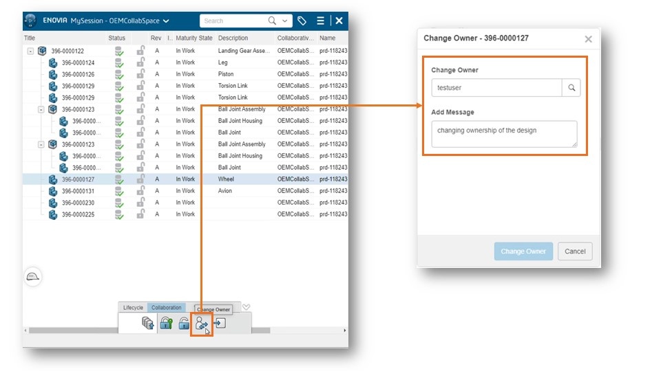

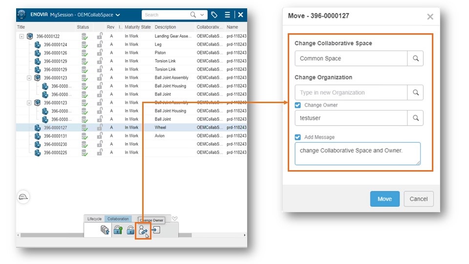

Change Ownership of CAD Components |
Why Save time managing NX components with the ability to change ownership from within your CAD session |
How
Change Login Credentials |
Why Save time managing NX components with the ability to change the Collaborative Space and Organization from within your CAD session |
How

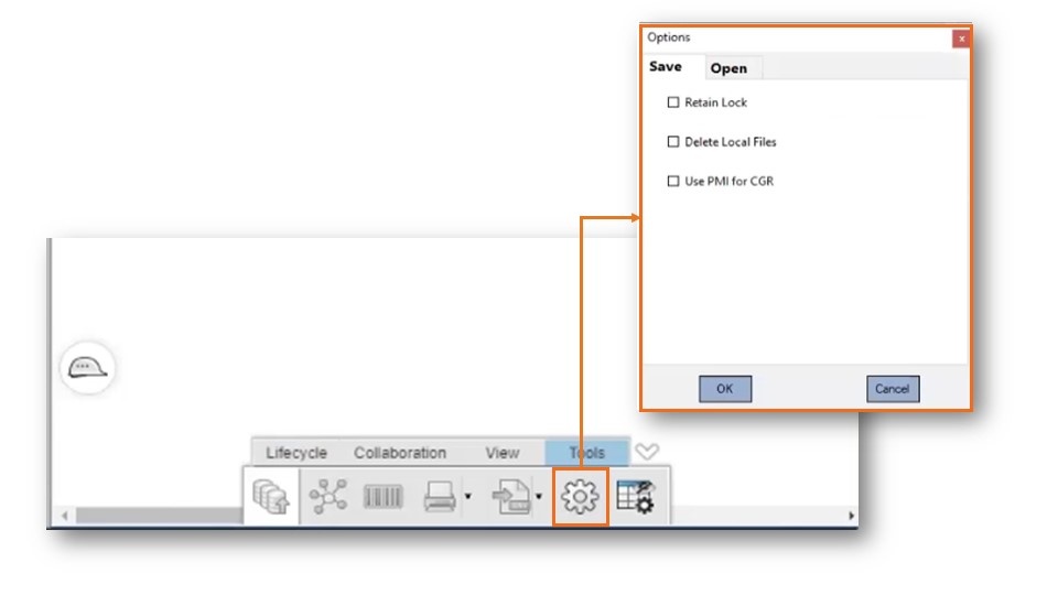

Change MySession Settings |
Why Enhanced control of Session settings through control using the MySession window |

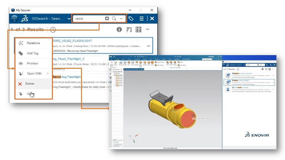

Open Design from 3D Search |
Why Quickly locate and open your design data with 3D Search from within the NX environment |
How

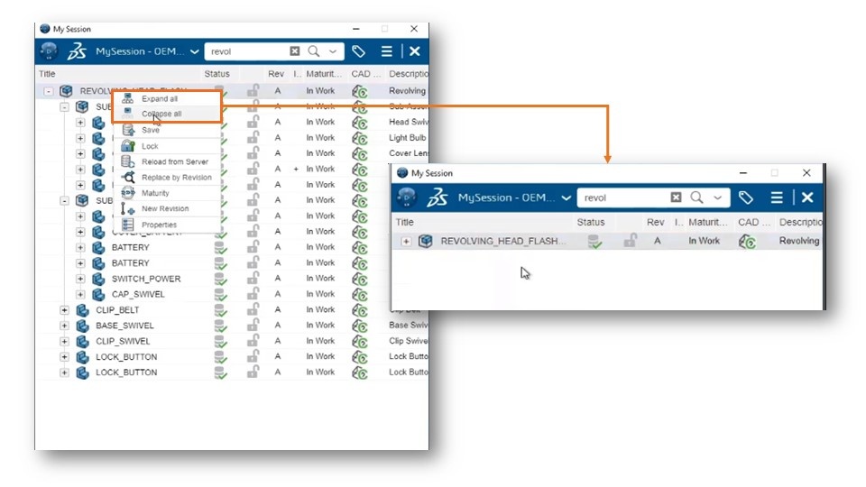

Expand and Collapse Product Tree |
Why Improve clarity of the product structure changing the content shown in the MySession product tree |
How

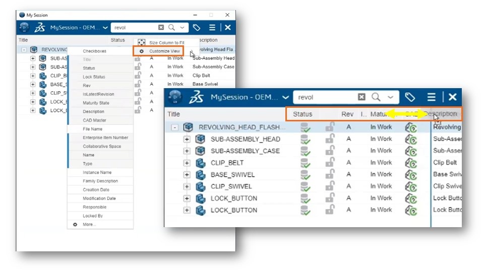

Customize Columns and Attribute Display |
Why Personalize the product details shown in the MySession product tree |
How

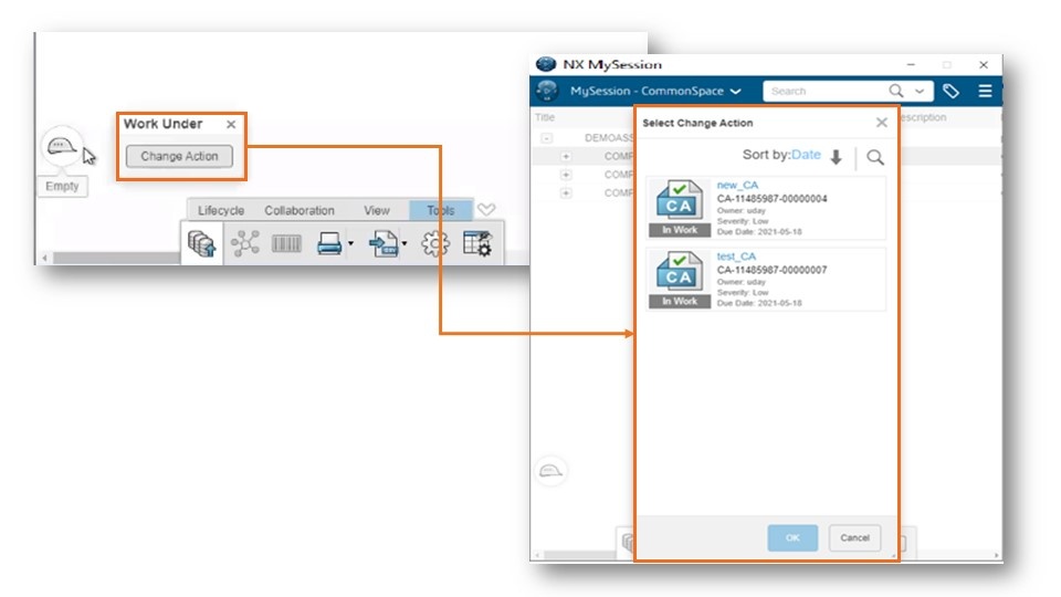

Work Under Change |
Why Work under an existing Change Action to automatically track changes to the design |
How

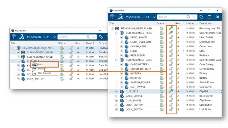

Access Rights to CAD Components |
Why Lock and unlock design components during the design session to ensure exclusive control over changes |
How

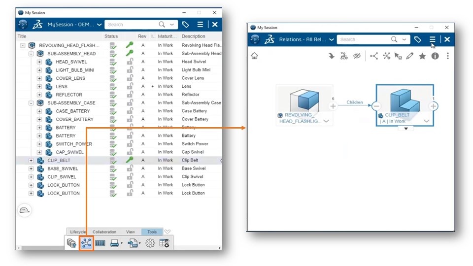

Access Component Relations |
Why Quickly expose relationships in the structure |
How

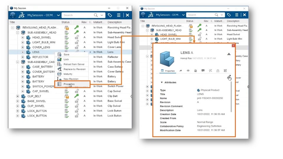

Manage Component Attributes |
Why View and update the attributes directly from your design session |
How

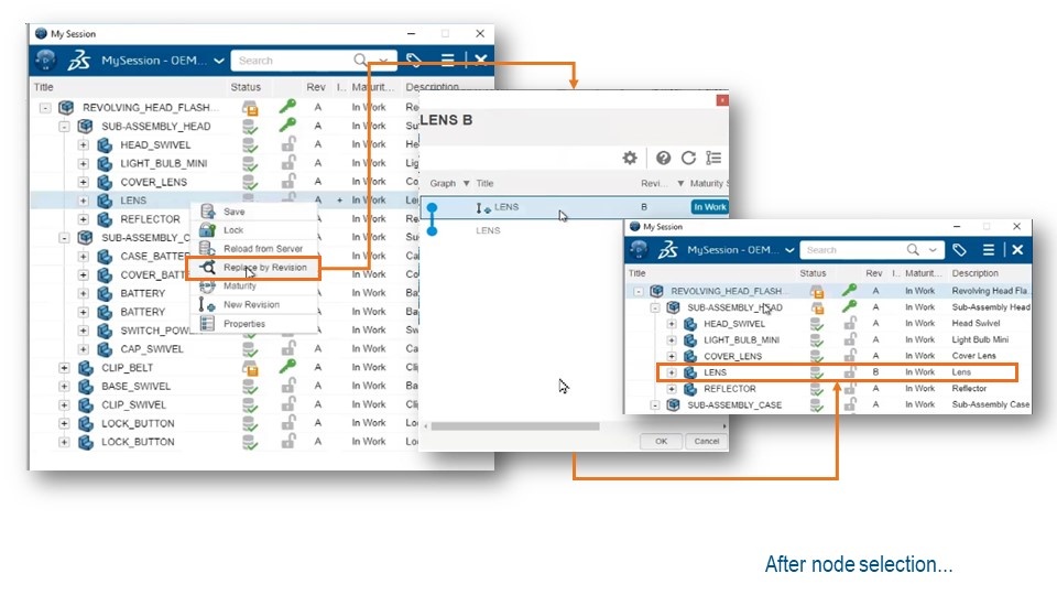

Replace Revisions |
Why Replace the component with a different revision to better understand changes |
How

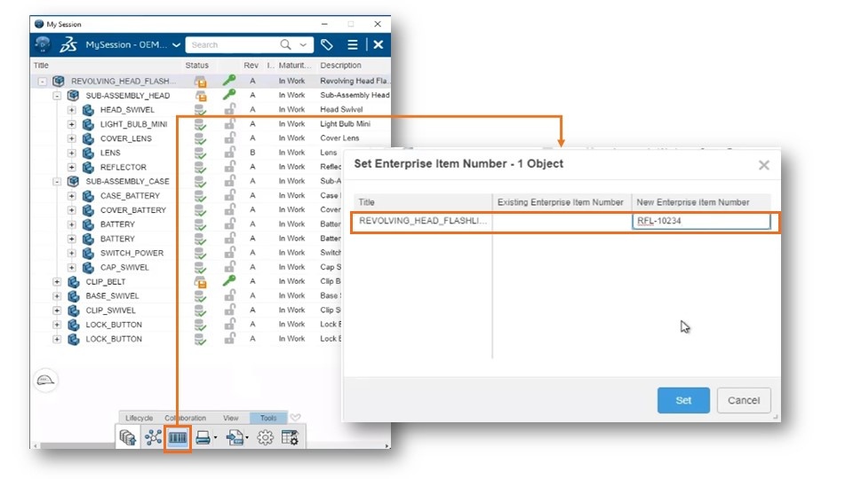

Set Enterprise Item Number |
Why Assign Enterprise Item Numbers to components directly from within the NX session |
How

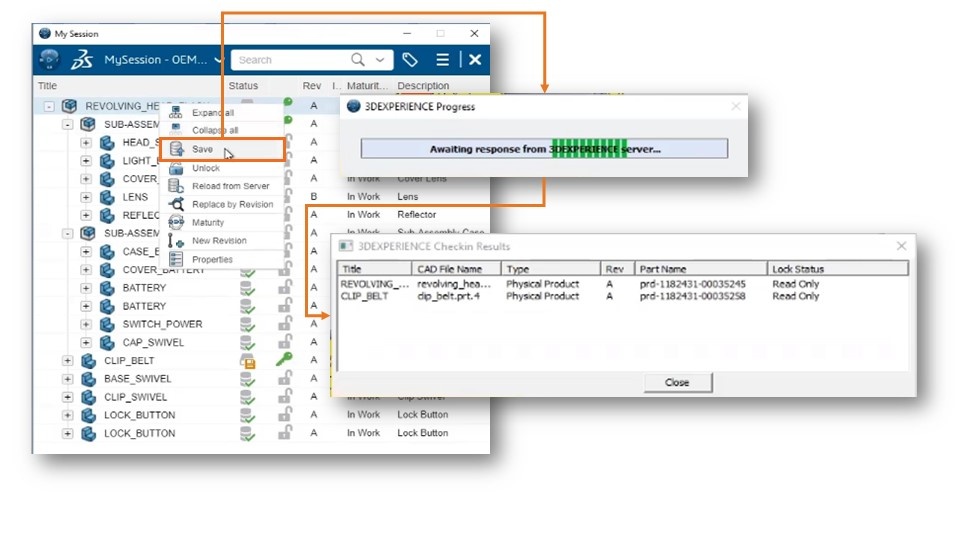

Save to Platform |
Why Quickly save your design to the platform at any point in the design effort |
How

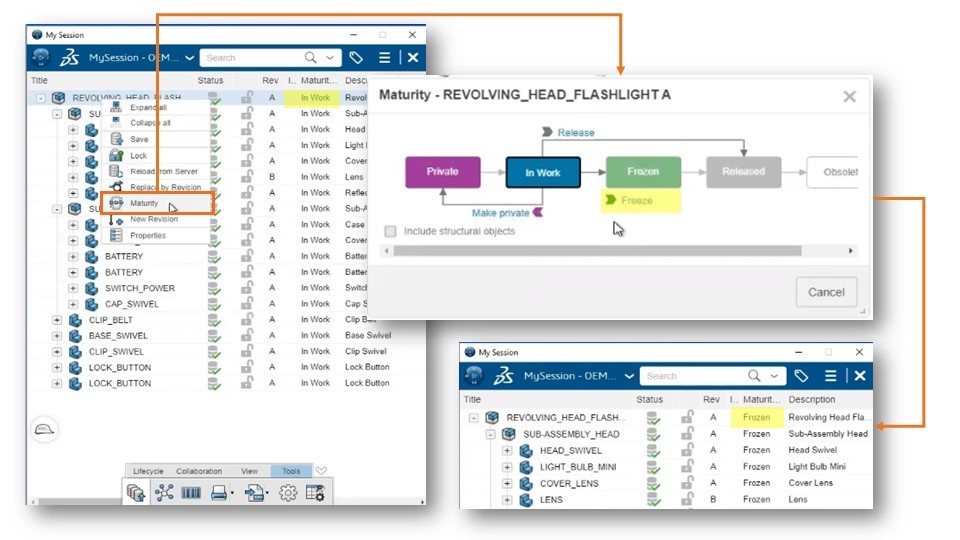

Change Maturity of Design Data |
Why Change the state of any component in the structure |
How

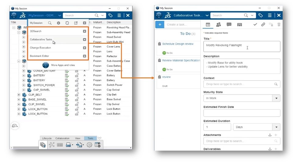

Access Platform Applications |
Why Save time launching supported platform applications |
How
