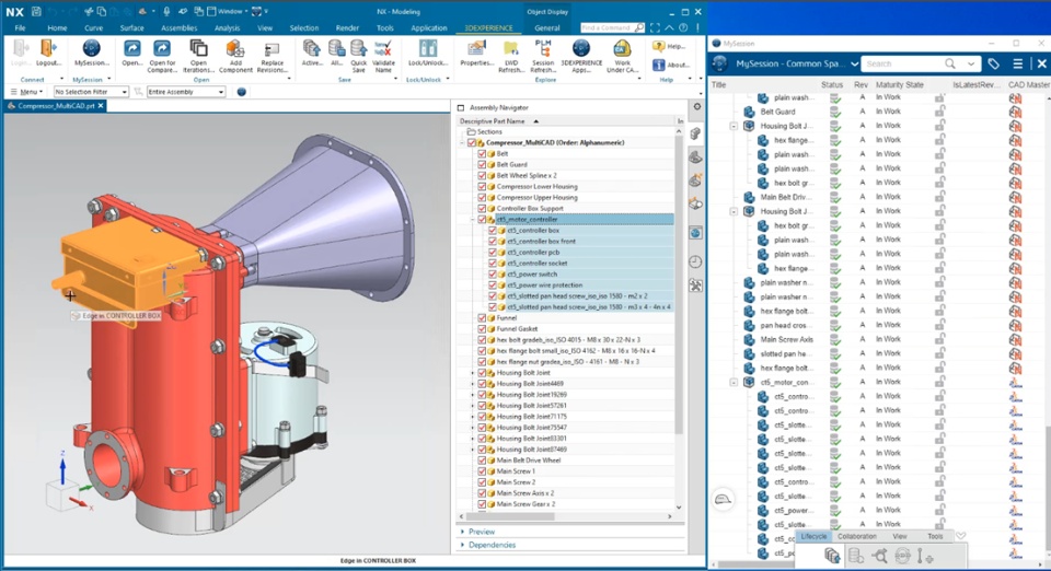

Insert CATIA V5 and SOLIDWORKS Products under NX
Why
Insert SOLIDWORKS and CATIA V5 assemblies directly into an NX assembly to enhance design flexibility in multi-CAD environments
How
•Users can now insert CATIA V5 and SOLIDWORKS assemblies into an NX assembly within the NX application
•Save, delete and reposition of these sub-assemblies is fully supported from the CAD environment

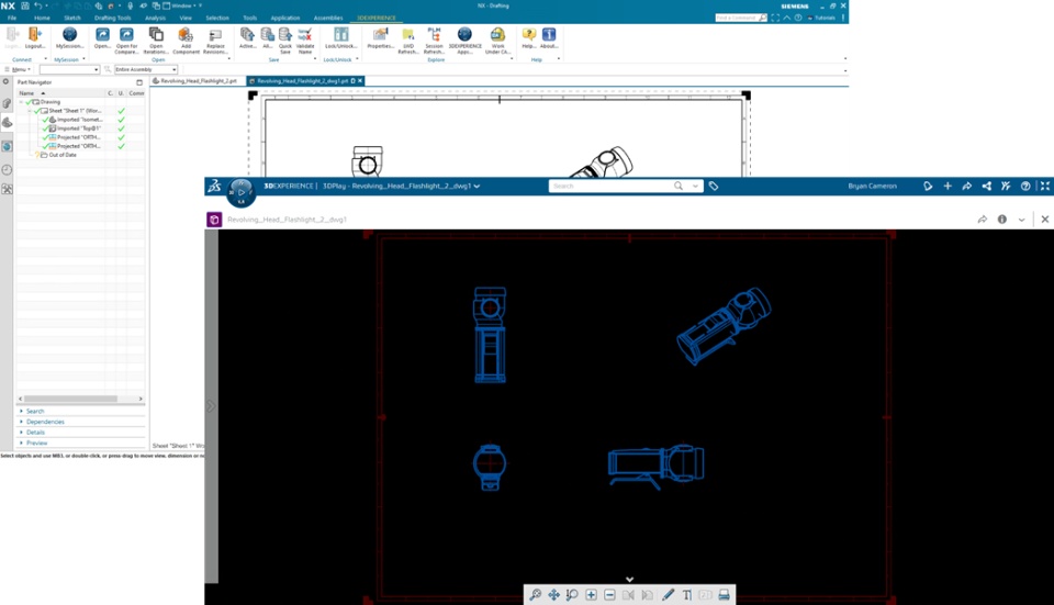

UDL Generation from DWG
Why
Streamline creation of UDL data during the saving of drawings to the platform
How
•The generation of the UDL data format pf the drawing will now be automatically requested at the time of check-in of drawing.
•The operation is based on the Server Based Derived Output rules. In the administrator console
Note that UDL is the “Unified Drawing Light” format which is the DS format for 2D visualization of drawings. 3D Play and 3D Markup are capable of reading this format and rendering the corresponding web views
