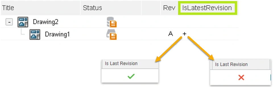

Align to New "Is Latest Revision" Icon
Why
Clearer understanding of the revision status through enhanced icons in the MySession window
How
Two new icons are introduced in the MySession window to make the status of the revision state clearer

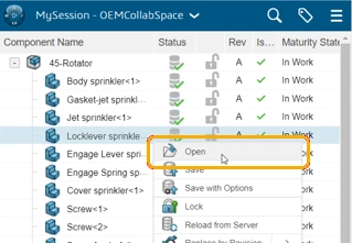

RMB Local Open from MySession
Why
Improve the ability to access parts and sub-assemblies directly from the MySession window
How
You can now select and open parts or sub-assembly into a new CAD session from the MySession window from within an existing assembly
