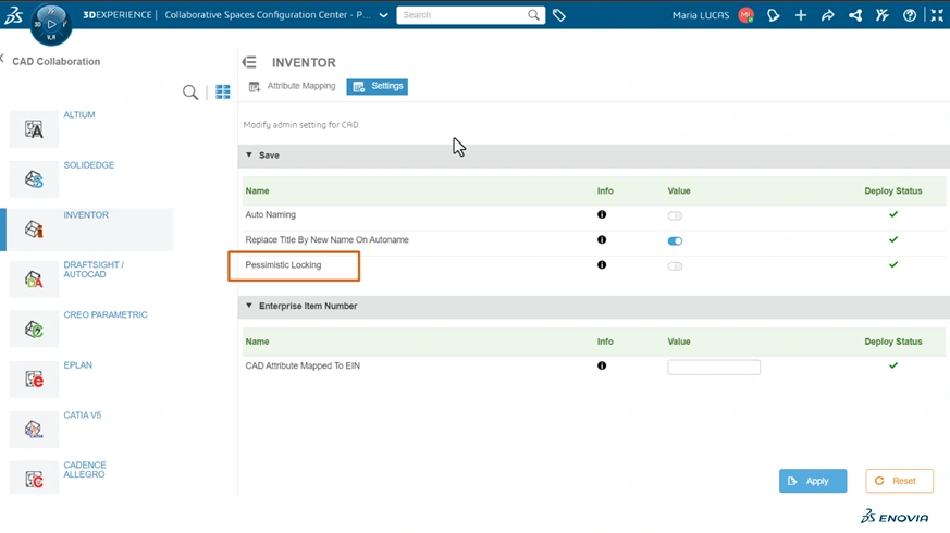

Optimistic / Pessimistic Locking |
Why Reduce the occurrences of overwritten data by enforcing user locks during edits of parts and assemblies |
How You can now activate the ability to prevent the saving of parts and assemblies if they are not locked by the current user (Pessimistic Locking) By default, parts and assemblies are excluded from save scope if they are not locked The Save prompt will allow you to Lock and Include the parts and assemblies in the current Save operation to streamline the use of the new capability |
