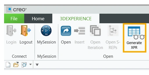

•Creo Parametric Ribbon 3DEXPERIENCE command “Generate XPRs”
NOTE: Users with expanded rights can use the Generate XPR command to create the additional entries within the tables if needed outside of the CAD session.

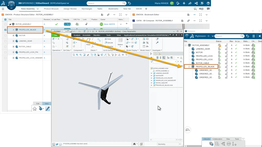

Open after Replace Operation from Web
Why
Product structure changes in the Product Structure Editor are recognized by Creo Parametric for expanded control of engineering definition
How
Changes that are made in the 3D Product Architect role are now reflected in the Creo Parametric design when opened into session
Replaced parts will be reflected in the model tree and the correct relations between the components is maintained
NOTE: Additional enhancements to the Save and Open functions have been made to support this enhancement but do not impact their use
