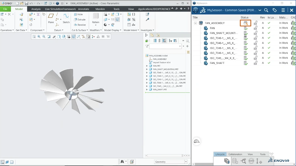

MySession Status Reflects Modification in Web
Why
Assembly modifications are displayed as out of date in NX promoting a more accurate product definition in session
How
You can now see and act on the  modifications made from Web users or 3DEXPERIENCE native client users from within the CAD session

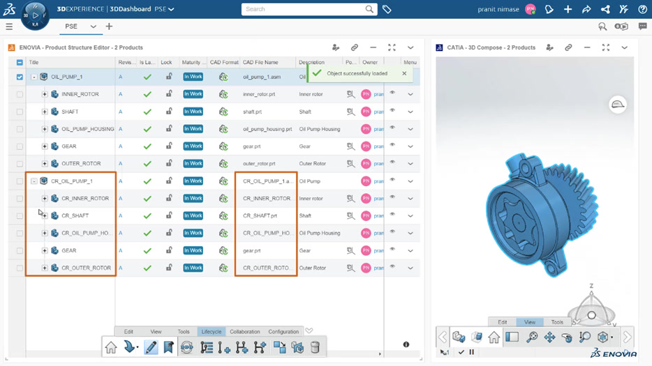

Advance Duplicate with Drawings
Why
Improve the stability pf duplicated assemblies through correct renaming of the underlying duplicated files
How
You can now duplicate a product and the resulting structure of the assembly and children will get updated filenames
