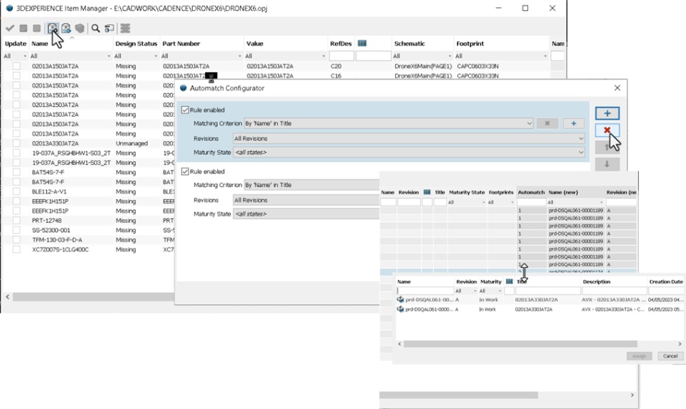

Detection of existing components during import into Electronics Component Editor
Why
Enhance data import accuracy by checking for duplicate components prior to import
How
•You can now check whether matching electronic components already exist in 3DEXPERIENCE prior to import of new libraries
•The function limits the checks for existence to electronic components in the libraries
Auto-match Feature to Detect Multiple Objects
Why
Reduce errors in component definitions by detecting existing components managed in 3DEXPERIENCE
How
•Prior to saving a new design to the platform, existing components are validated using rule-based checks to locate the correct components to reduce errors
•This function enables you to quickly identify and select an individual component out of multiple components when mapping components in the design
