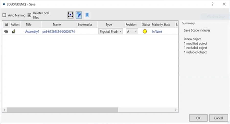

Delete Local Files on Check In
Why
Retain needed file space and protect your valuable IP by automatically removing your saved drawings from the local drive
How
You can now clear the local cache of your saved drawings

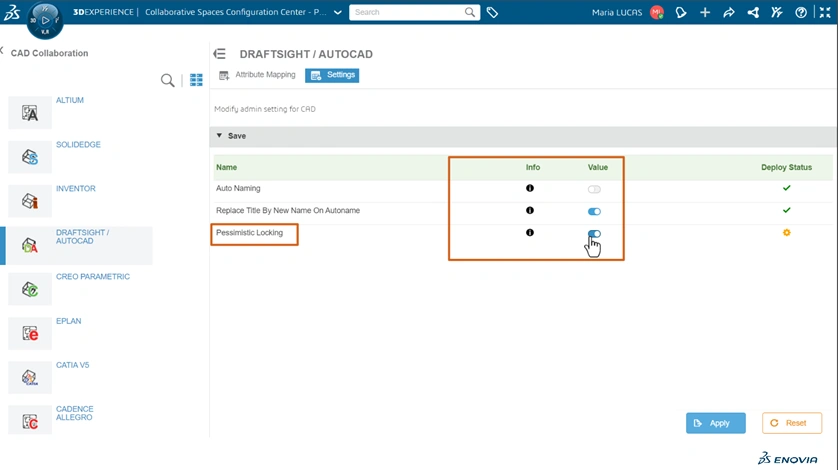

Optimistic / Pessimistic Locking
Why
Reduce the occurrences of overwritten drawing by enforcing user locks during edits of drawings
How
You can now activate the ability to prevent the saving of drawings if they are not locked by the current user (Pessimistic Locking)
By default, drawings are excluded from save scope if they are not locked
The Save prompt will allow you to Lock and Include the drawing in the current Save operation to streamline the use of the new capability
