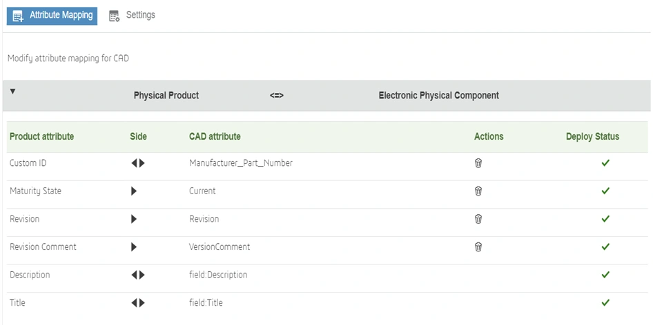

Automatic Assignment of Components
Why
The matching criteria used within auto-match rules is enhanced improving the accuracy of imported components
How
You can now extend the list of predefined matching criteria within the Item Manager’s auto-match feature.
The matching criteria will be automatically derived from 3DEXPERIENCE mapped attributes.
Additional matching criteria can be supplied with a client-based definition file.

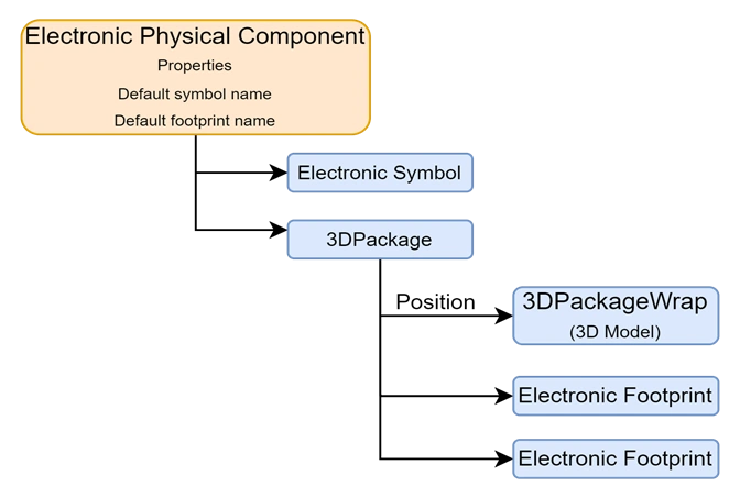

Reuse of 3DPackages During Import for Altium Designer
Why
Improve the association between MCAD and ECAD through common references to 3D CAD models in the ECAD structure
How
You can now import common 3DPackages with the Electronic Component Editor avoiding the creation of duplicate 3DPackages (CAD Models) when other Electronic Physical Components in the import use identical 3DPackages.
Further changes to any Electronic Physical Component that use the 3DPackage will reflect that change on all other components that use the package within the import
