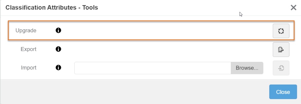

Migration Path for Classification Attributes
Why
Fully manage all Classification Attributes without Attribute Group in dashboard
How
A new option, Upgrade, was added to the Classification Attributes – Tools dialog.
The Upgrade option allows you to convert the Classification Attributes already created in the ‘Classification Editor’ web application to the new mechanism
Following the upgrade process, you can fully manage the converted attributes in the ‘IP Classification Editor’ Widget

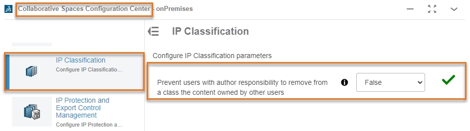

Declassify Other Owners Data
Why
Prevent data loss using a new setting to control the content that Authors can declassify
How
New setting, ‘Prevent users with author responsibility to remove from a class the content owned by other users’ is introduced.
The setting is available in ‘Collaborative Spaces Configuration Center’ under ‘IP Classification’ section.
It defines whether Author user should be prevented from disconnecting other owners data.
The setting has two optional values:
  • False (the default value):  Authors can declassify content which is not owned by them.
  • True: Authors cannot declassify content, which is not owned by them.
