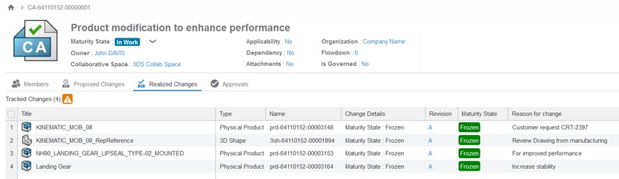

Data Grid View in “Realized Changes”
Why
Improve the review and the approval processes of the captured “Realized Changes”
How
1.The default view in the “Realized Changes” of the Change Action” grid is now “Data Grid”. This helps you to view the change info without the need to expand the loaded view. You can right-click on the header to use the “Filter” to filter the list.
It is also possible to switch the view back to the “Large Tile View” as needed.
2. You can now set the “Reason for Change” for certain captured changes, to better explain the implementation of the change.

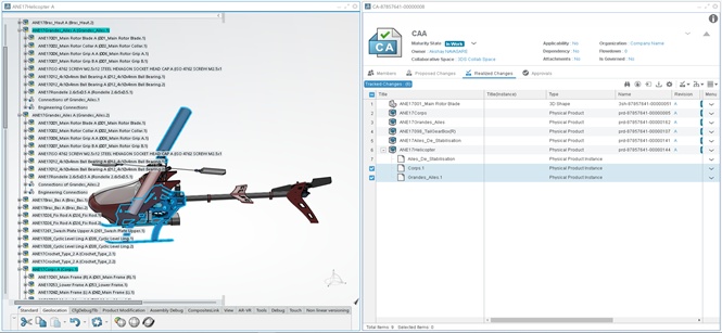

Bi-directional cross-highlighting from “Realized Changes”  to CATIA native app
Why
Enhance understanding of the product during the review of the Change Action “Realized Changes”
How
•As a CATIA native user working with the Change Action widget in CATIA, you can now navigate the Realized Changes and visualize them in 3D
•You can use the bi-directional cross highlight
Note:
Only the CATIA app ‘Product Structure Design editor” is supported.
