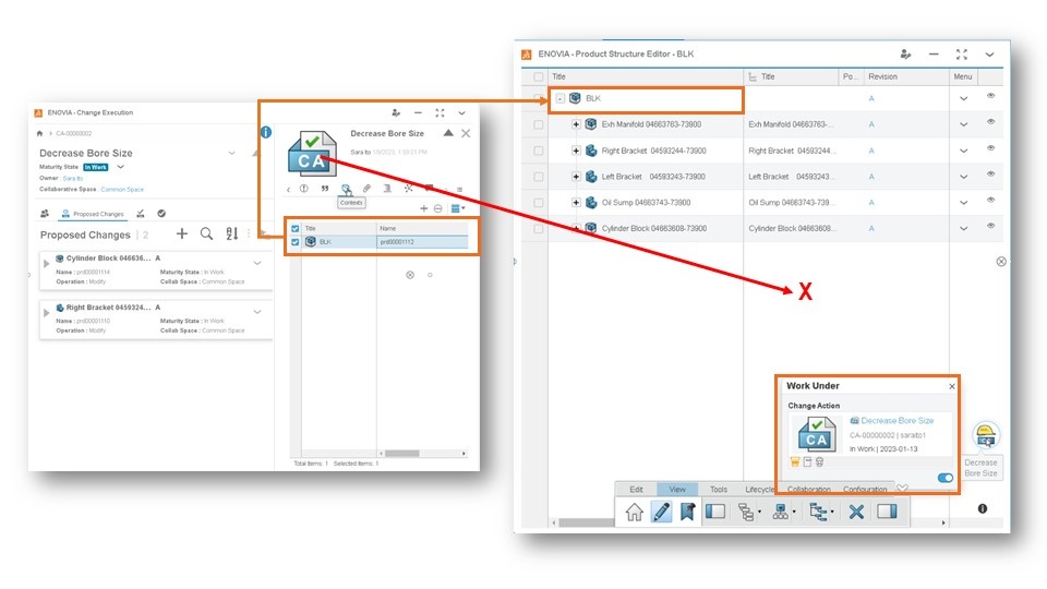

Support Drag & Drop of Change Actions with Context
Why
Streamline governance processes through access to Change Action content
How
You can now load the Context of a Change Action into the Product Structure Editor, as well as set the work-under status, by a drag & drop operation.

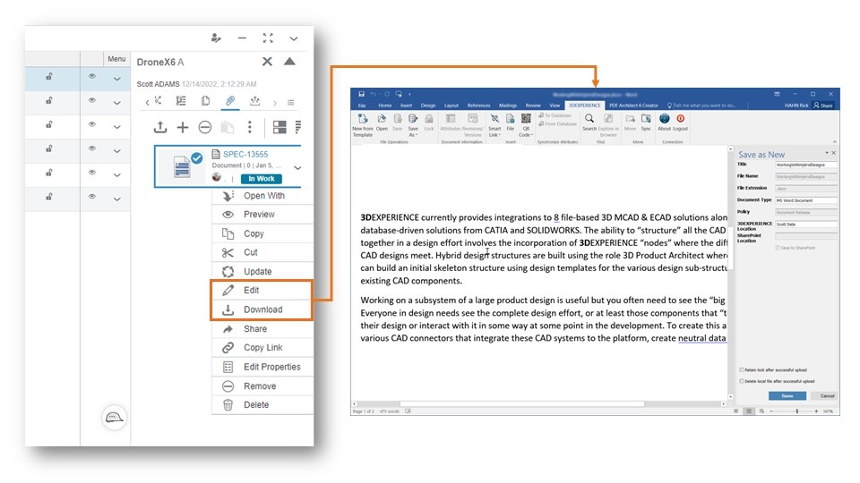

 Support for Document Edit and Download
Why
Streamlined Access to MS Office applications for attached documents and specifications
How
You can now open the associated Microsoft application automatically during Download or Edit if a document from within the Product Structure Editor.
When the Collaboration for Microsoft is enabled, editing of MS documents is automatic, ensuring proper governance is applied.
    - Edit: Opens MS document in the native tool and invokes the MS Office Integration
    - Download: Downloads and Opens MS document in native for “view”
Available also in role: Collaborative Industry Innovator (CSV) in Product Explorer application

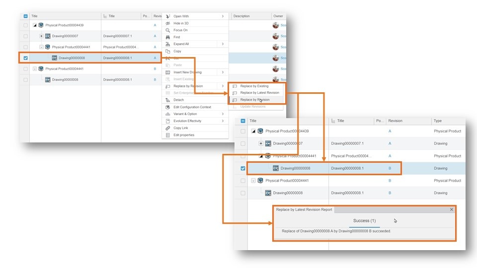

Support Drawing in Replace Commands
Why
Improved flexibility in drawing revision management from the Product Structure Editor
How
You can now replace the revision of a Drawing independently of the parent product in a physical product structure.
This enhancement affects the following five commands
    - Replace by latest Revision
    - Replace by Revision
    - Replace by Existing
    - Update Revisions
    - Update Revisions on Entire Structure

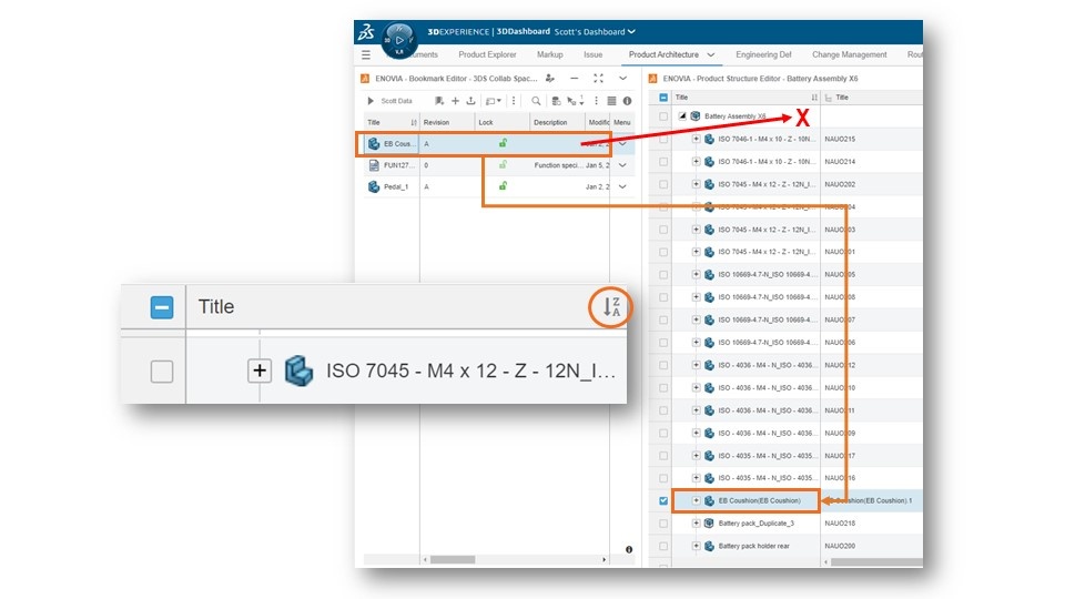

Keep the User Sort Persistent When Attaching Multiple Data to a Product
Why
Improved control of grid views through consistent display of data
How
You can now sort the active column in the grid view and it remains persistent when a new item is pasted or drag & dropped into the grid view.
Drag & drop and paste operations give the user more options in choosing the sorting criteria before attaching the data to a product.

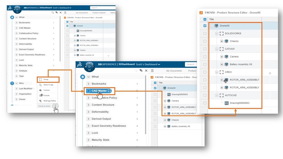

Grouping with 6WTags in Index Mode
Why
Organize and refine your product structures using groups based on tags
How
You can now organize the 1st level of your product structure by creating groups in 6WTags
First level objects that do not have a value corresponding to the selected 6WTag will be placed in a group named Other.
Support of Hierarchical 6WTags
Why
Create and organize a flat product structure into a hierarchical view for better understanding of the content
How
You can now create and use hierarchical tags to enhance the view of a flat product structure using groups.
There are 2 different views for hierarchical groups:
  Compact Group Layout - the selected groups inside the tagger are created directly below the root.
  Structured view Layout - the selected groups inside the tagger are created with their hierarchy from the root classification.

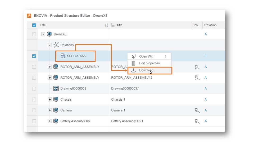

Download Documents from the Data Grid View
Why
Streamline access to documents attached to the product structure
How
You can now download a document from the data grid view be exposing the relations.
It is no longer necessary to navigate in the view pane to download attached documents.
