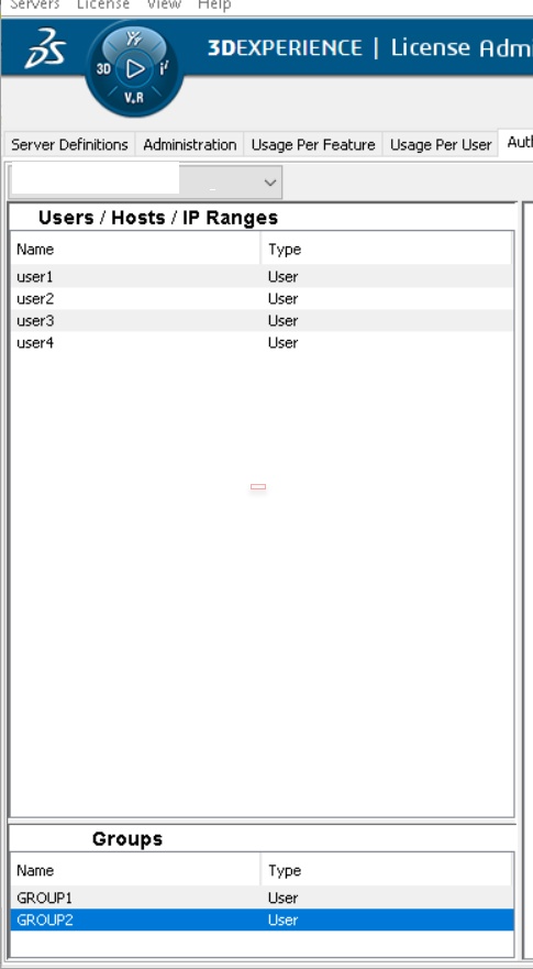

Define users or groups to define authorization rules:
  • Launch DSLS License Administration Tool
  • On Server definitions tab check server is connected
  • Go to Authorizations tab, Right click in a blank space under Users\\Host\\IPRanges and select Add.
  • Add Users\\Hosts\\Groups
We can see in above image that  4 users and 2 groups are defined. We will assign the group of users to access the certain licenses only. (You can see users added in certain group by double clicking on it)
NOTE: Usernames are the windows login username and hostnames are system names.

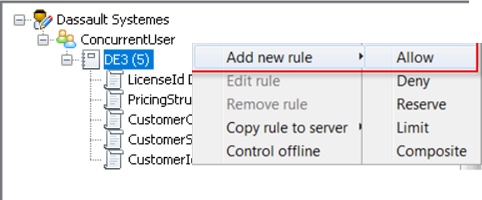

Add authorization rules:
To add the rule, go to Authorizations tab >right click on the license you intend to add a rule to and select Add new rule.

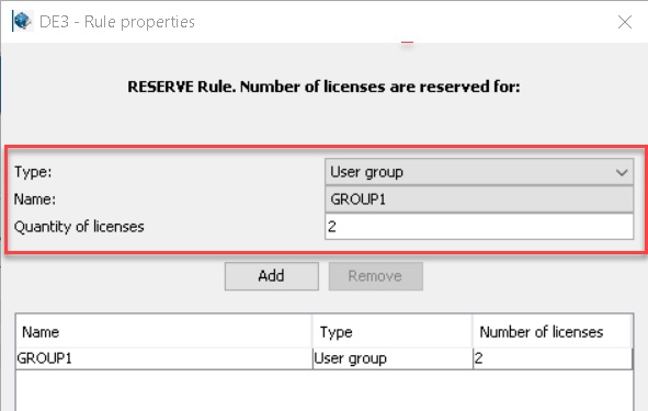

Select Allow/Deny/Reserve/Limit/Composite. We will use Reserve to reserve Enterprise Plus licenses to users (user1, user2) in this group so that other users will not be able to get these 2 Enterprise Plus licenses.
Similarly we can apply different rules to different licenses and manage how the licenses will be used.

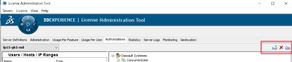

We can also export the authorization file as .xml> edit it and reimport it.
