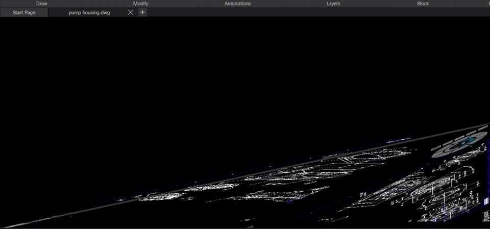

An issue has been identified in DraftSight after updating NVIDIA graphics drivers to version 32.0.15.9597. This issue causes UI/visual corruption across all versions of DraftSight, regardless of whether you are using the latest release or an older version.
It was reported in BR10000423046 to our R&D team. For more details about this issue, please refer to:

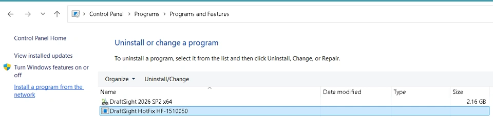

  • Verify that the hotfix appears in Programs and Features with the correct HF number.

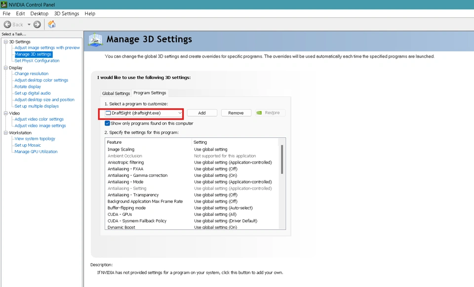

  • Confirm that DraftSight.exe has been added under NVIDIA Control Panel > Manage 3D Settings > Program Settings.
