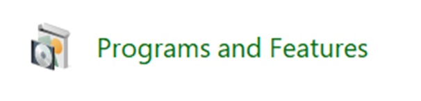

1. Open the Windows > Control Panel  (Type "Control Panel" into Windows Search tool on the Task Bar)
2. Select Programs and Features
3. From the list of Programs, right click on 'DraftSight Hotfix 1227133'
4.  Select "Uninstall/Change" and follow the steps to remove the Hotfix: DraftSight Hotfix 1227133
