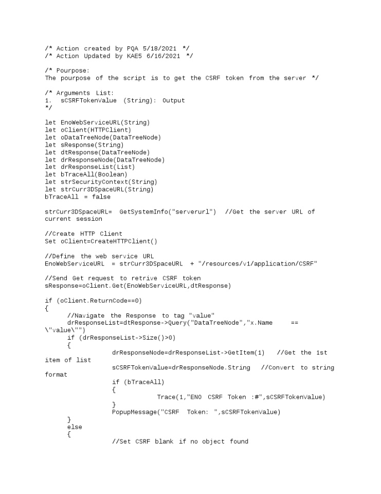

Below is the ready to use EKL Script. You can create a knowledge action to execute this script in a PPR.
GetCSRFToken EKL
Explanation
Below is the step by step introduction of the script.
1. We need the URL of the current 3DSpace Server. The line of code given below is used to get the server URL.
strCurr3DSpaceURL= GetSystemInfo("serverurl") //Get the server URL of current session
2. Create a HTTP client which will be used to send requests to the 3DSpace
//Create HTTP Client
Set oClient=CreateHTTPClient()
3. Define the web service URL to Get CSRF token.
//Define the web sevice URL
EnoWebServiceURL = strCurr3DSpaceURL + "/resources/v1/application/CSRF"
4. Send "Get" request to the 3DSpace Server. The response is returned in the form of DataTreeNode (JSON).
//Send Get request to retrive CSRF token
sResponse=oClient.Get(EnoWebServiceURL,dtResponse)
5. Extract the received DataTreeNode (here, dtResponse) to extract CSRF Token.
//Navigate the Response to tag "value"
    drResponseList=dtResponse->Query("DataTreeNode","x.Name  == \\"value\\"")
    if (drResponseList->Size()>0)
        drResponseNode=drResponseList->GetItem(1) //Get the 1st item of list
        sCSRFTokenValue=drResponseNode.String //Convert to string format
        if (bTraceAll)
            Trace(1,"ENO CSRF Token :#",sCSRFTokenValue)
The "sCSRFTokenValue" string variable is returned to the EKL Action which calls this Action file.

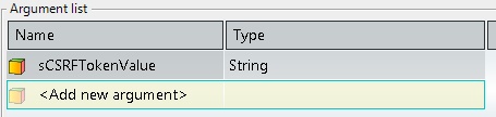

2. Set the input arguments in the Knowledge action as given below.
