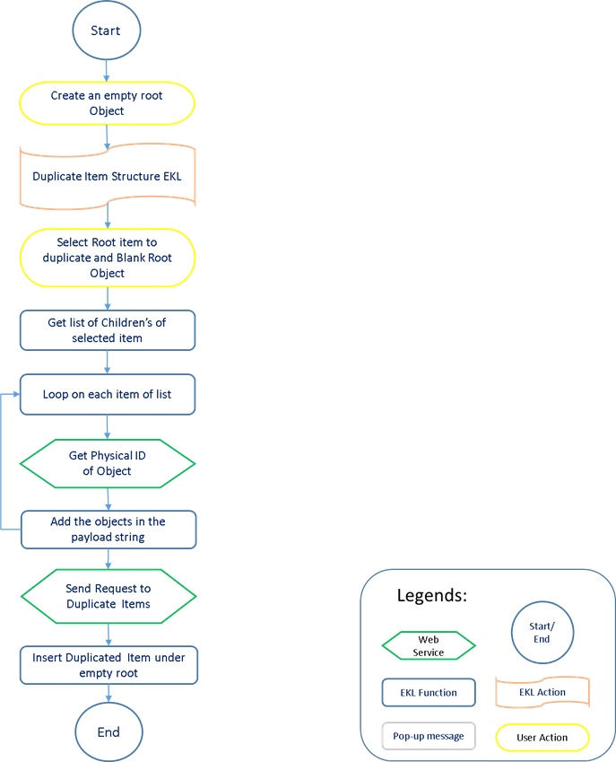

Logical Flow
Below is the logical flow of the script to duplicate the item structure.

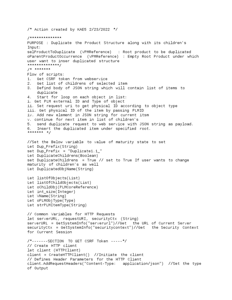

Duplicate Product Structure EKL Script
Duplicate MFG Item Structure EKL
Duplicate System Structure EKL Script
Detail Explanation
This document only describes the script for duplicating MFG Item structure. The scripts for Product and Systems are same with some modifications.  Already prepared scripts are also attached above.

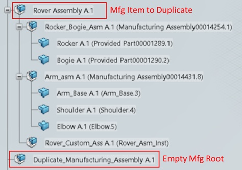

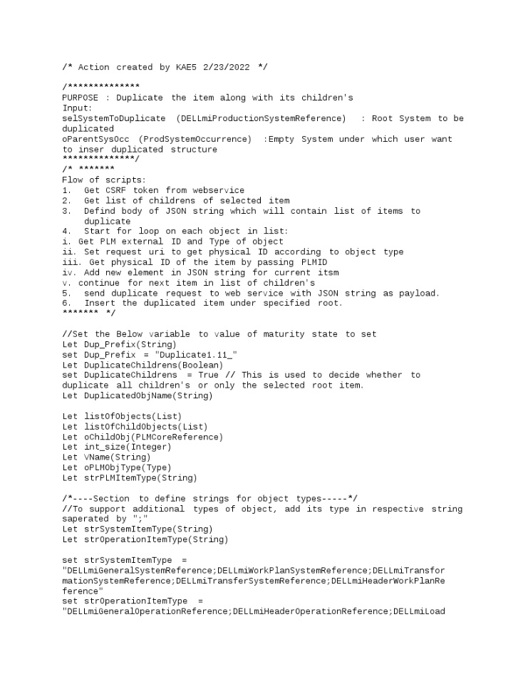

1. Insert one new manufacturing assembly (Empty root) in the PPR Context. (For product, insert Empty Product. For System, add empty general system or work plan). Below image shows example:

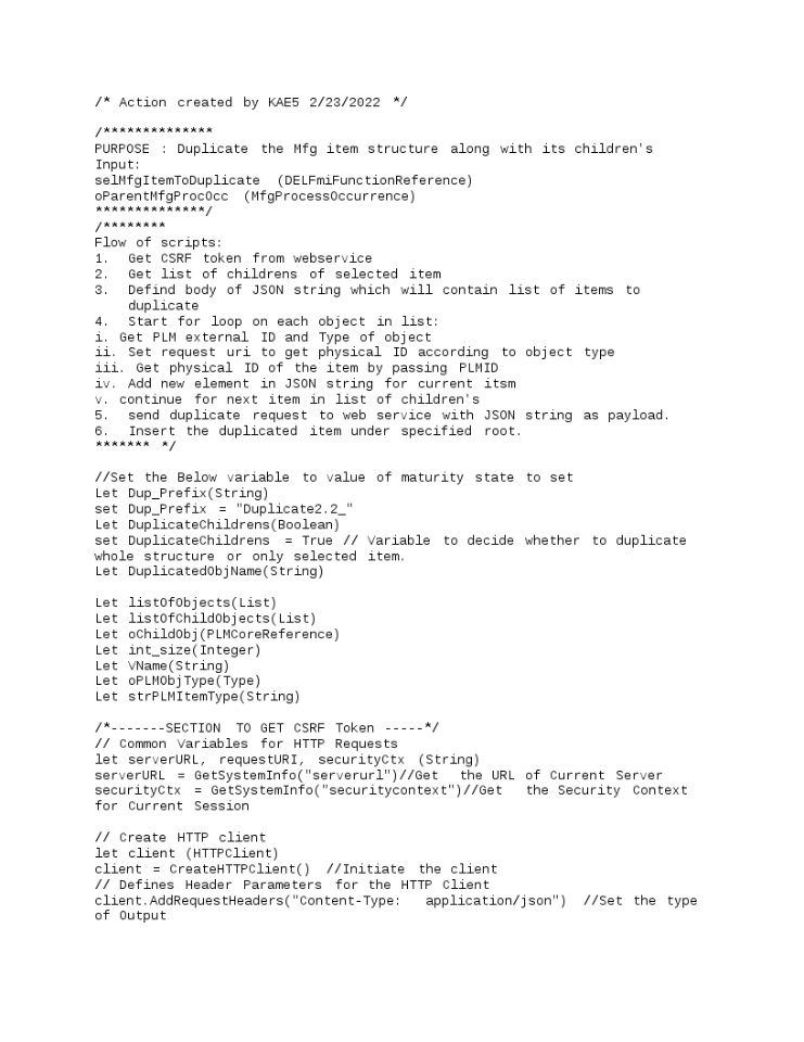

2. Open the EKL script, and edit the value of “Dup_Prefix” string with desired prefix for duplication
set Dup_Prefix = "Duplicate2.2_"
Note:
  • It is not possible to insert the Mfg. Item, Product or System root directly in PPR Context using EKL. So, a blank Root item is created.
  • Inserting the item under PPR can be don manually:
    • Right Click on PPR Context.
    • Select “Insert Item -> Manufacturing Assembly”. (Do same for other types of items)

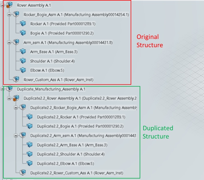

The below image shows the structure after duplication.

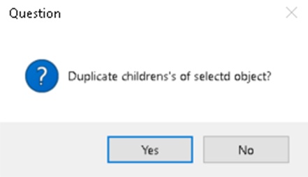

Option to duplicate with children.
When the script is executed, one dialogue box appears, which asks user whether to duplicate children also. According to response of user, either the whole structure will be duplicated or only selected item will be duplicated.
The code given below is responsible to show the dialogue box.
//Show dialogue box to decide whether to duplicate children's or not
set DuplicateChildrens = Question("Duplicate children's of selected object?")​​​​​
A list of objects is created.
  • If user selects "Yes", selected item and its child's will be added in list.
  • If user selects "No", then only selected item will be added in list.
Objects in the list will get duplicated.
The code given below will manage the items to add in the list:
listOfObjects->AddItem(selMfgItemToDuplicate, 1)  //Add Selected Mfg item root
If DuplicateChildrens
     listOfChildObjects  = selMfgItemToDuplicate->Query("PLMCoreReference", "") // This list will contain all the children's of select MFG item
     listOfObjects = listOfObjects + listOfChildObjects //combine both the lists
How to construct JSON Payload String?
To maintain the relations like Parent-Child relations, implement links, etc. after duplication, we need to send single request to web-service by passing the list of Object IDs of all the items which needs to be duplicated.
Below is the syntax of JSON string:
  "affix": "Duplication Prefix",
  "data": [
           { "id": "PhysicalID1", "identifier": "PhysicalID1", "type": "Instance Corpus Type",    "source": "https://ve4al702dsy.dsone.3ds.com:443/3DSpace", "relativePath": "/resources/v1/modeler//PhysicalID1" },
           { "id": "PhysicalID2", "identifier": "PhysicalID2", "type": "Instance Corpus Type", "source": "https://ve4al702dsy.dsone.3ds.com:443/3DSpace", "relativePath": "/resources/v1/modeler//PhysicalID2" }
Here, replace the value of  "source" element with your server URL
"For Loop" will be executed on the list of objects created in previous steps. For each item in the list, its Object Id will be extracted and that ID will be added in the  payload string.
The code between below two comments in attached EKL script will be responsible to get physical IDs of objects and construct the JSON string:
/*-------SECTION to construct JSON Payload for duplication-----*/
/*-------End of: SECTION to construct JSON Payload for duplication-----*/

How the script to duplicate product and system works?
  1. The scripts for duplicating Product and System structure are similar to this script with nominal changes. The types and names of input parameters will be different.
  2. The Web-Service URIs to get Physical ID will be different for different types. In script for systems, as the URI for Systems and Operations are different, there will be condition to check the type of object and select URI accordingly.
  3. The function to inert the object is different for different type, so code to insert the duplicated item under empty root will be different for each type.
The scripts for Product duplication and System duplication are also attached above.
