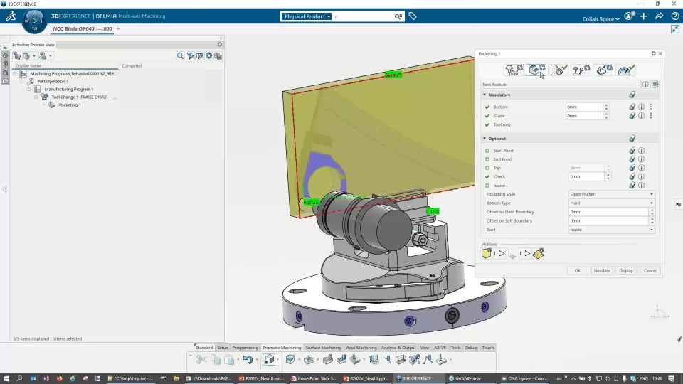

In 2021x, where is the option to switch between old and new method ?
Available in the Preferences > NC Machining Apps Common Services > Operation > User Interface
- Legacy Interface
- 3DExperience Interface : new interface available in R2022x
Could you tell me more when the Cloud version will be updated to 2022x ?
The Cloud migration to R2022x is planned for middle November
Did i understand this right, that the old 2021x interface is no longer available in 2022x ?
Yes, the old UI is no longer available in R2022x. Only the new UI is available now.
Will there be a Env. Var to be able to switchback to the old interface in case the customer has difficulties using it?
No, there is no solution to switchback to the old UI
How are you taking care of missing capabilities in new UI for the MOs ?
All functionalities are available with new UI. If it's not the case, feel free to contact me directly.
Did you also changed the Simulation Graphic User Interface ?
No change about simulation player and options
Where is the APT button in the new interface ?
The definition of the cycle for drilling or probing activities is always available using the button at the bottom of the dialog box
Is there any help material for customer that compares what was in the old interface vs. where it is in the new interface ?
Not yet, we are preparing it
Is there any training available for resellers ?
2 trainings with the new UI is already available : Wire EDM and Shop Floor Machining (NSR)
In Preferences, there is an option called simplified interface. What is that ?
It's an old and deprecated preferences for the old UI. This option will be removed soon.
