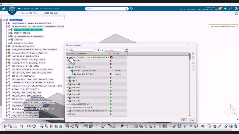

When working with revisioned or duplicated parts in DELMIA Machining it´s possible to reuse programs that have been created for earlier revisions. This way programmers can save time when making programs for new versions / revisions of existing parts.
