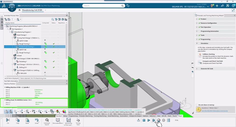

Program on 3D Milling machine with turning (ANDREA head) and Angular NC assembly
To test the new kinematic to create NC resources in current HF (R2026x HF4.41)  I have redo (from scratch) a 4 axis machine (+ C spindle for milling head or angular NC assembly positionning) .
I rebuild also the ANDREA head (U axis)
In this program I illustrate several 3DEXPERIENCE functionalities:

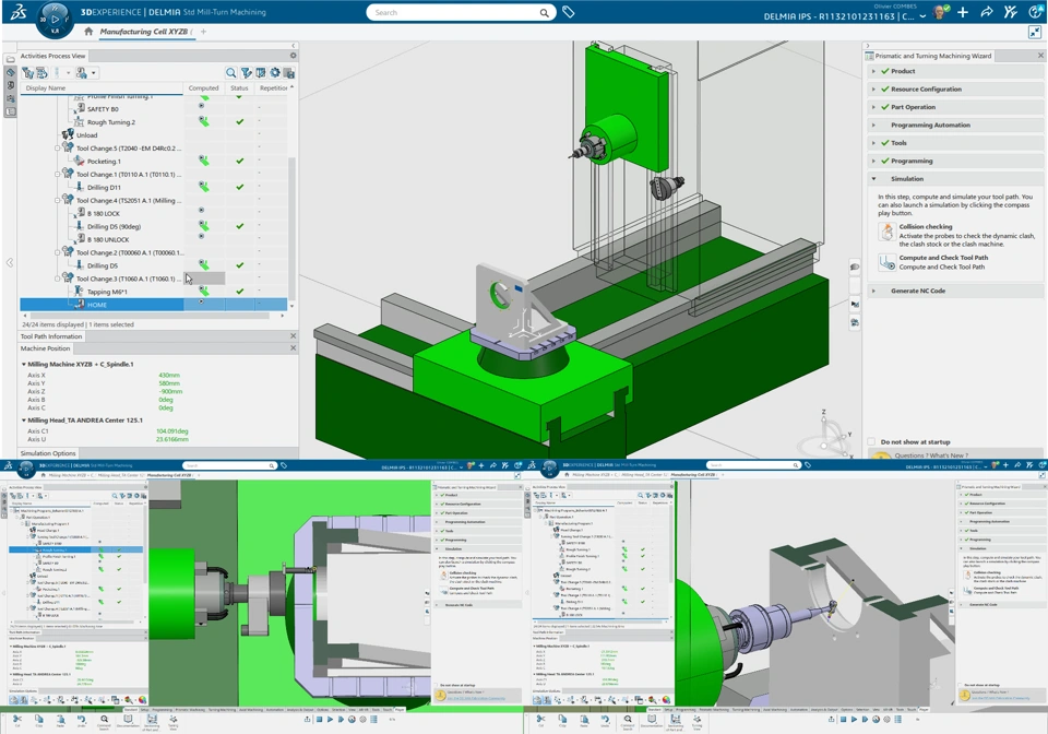

Program and simulate in 3D Machine context
Change Head (with ANDREA head for turning)
Milling and drilling (with angular NC assembly)
Turning on milling machine via ANDREA head (variable U Axis)
