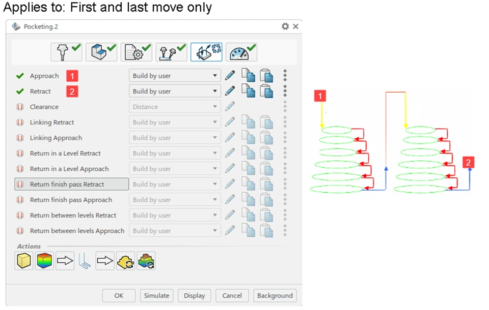

Approach and Retract

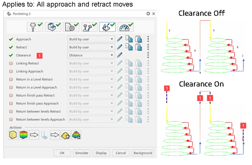

Clearance

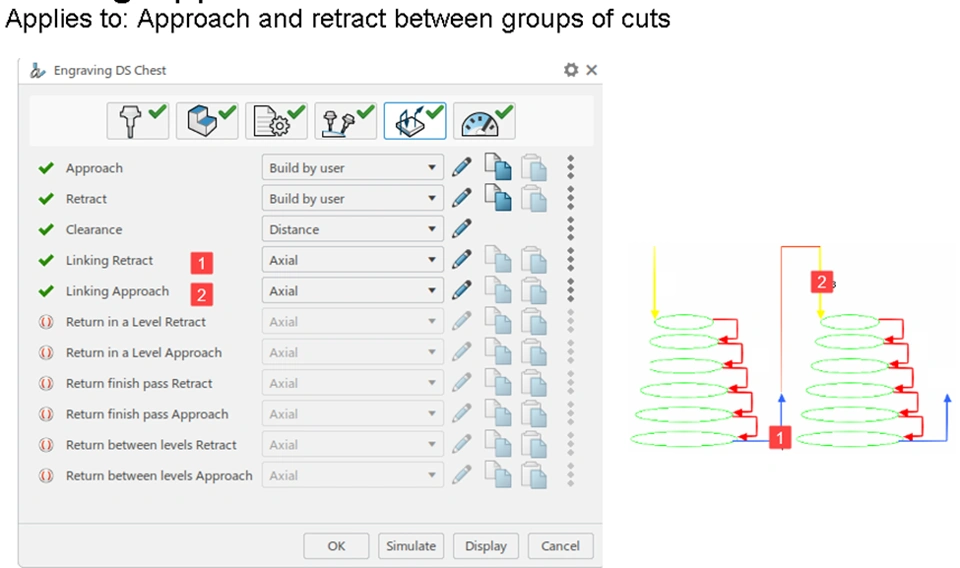

Linking Approach and Retract

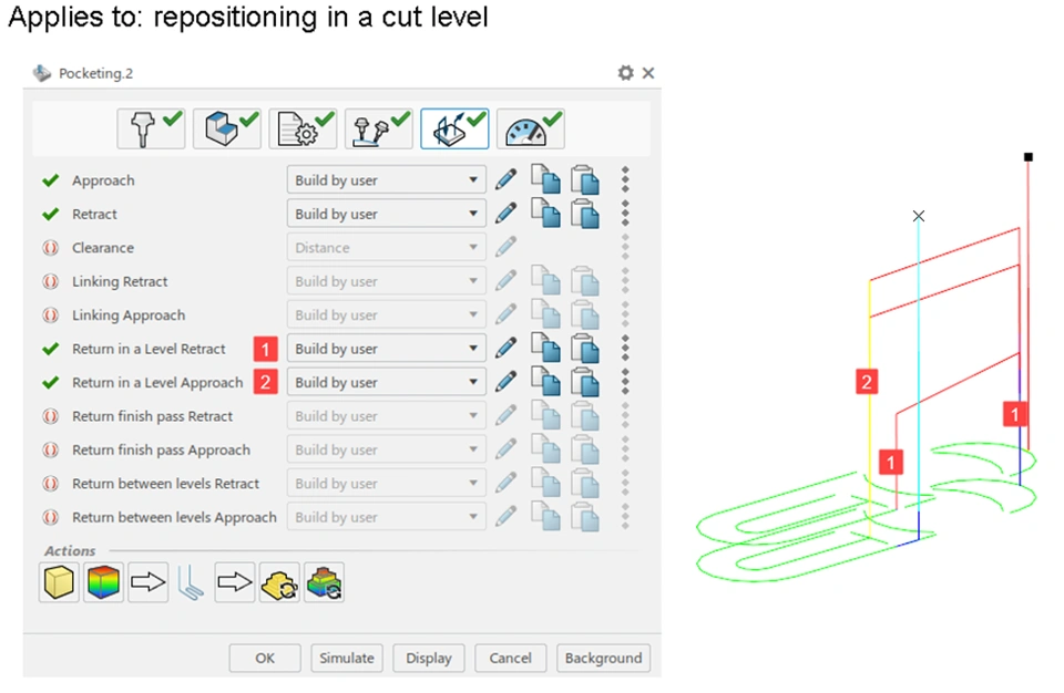

Return in Level Approach and Retract

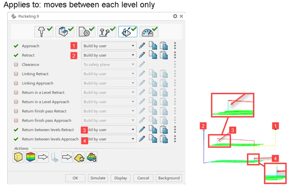

Between Levels Approach and Retract
