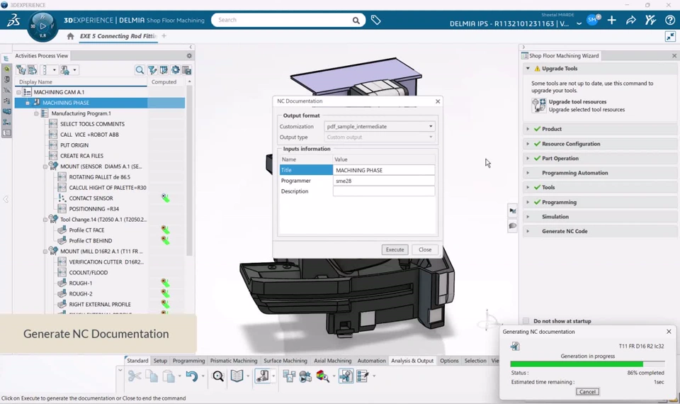

Below video shows how business rules can be configured to generate custom NC Documentation output.

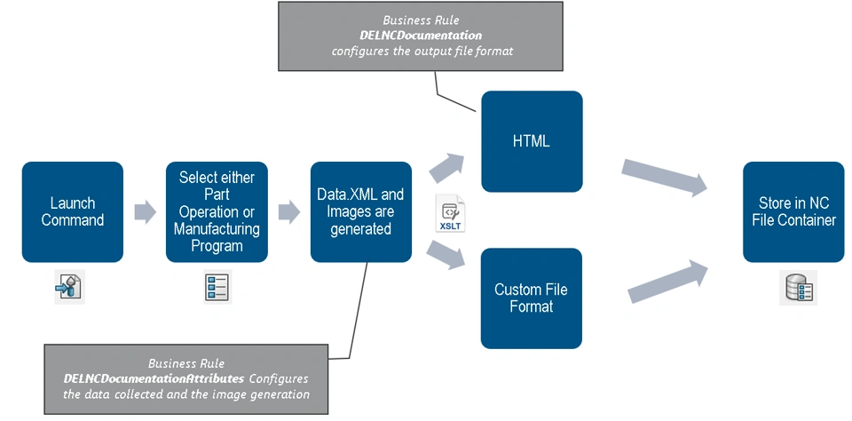

Logical Workflow
Detail Explanation

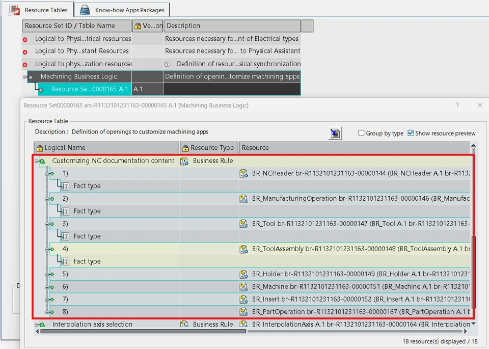

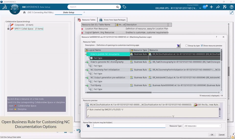

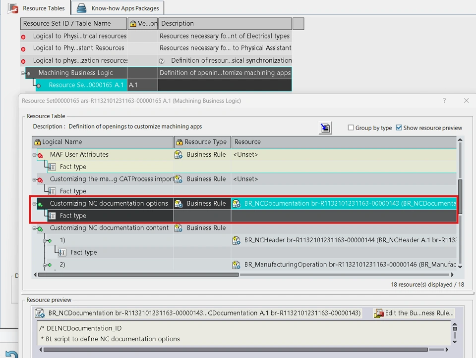

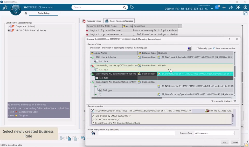

When we launch "Generate NC Documentation" command, two business rules are triggered which determine options available during document generation and the content of document. Let us see how they work in detail.
1.Business Rule for Customizing NC Documentation Options: DELNCDocumentation
During NC Documentation generation, this business rule determines the output type (HTML or PDF), output format (different document layouts available), logos to be added etc.
Below script will explain how these options are managed by the business rule.

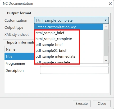

First define the list of customization keys
// Option to define available customization keys
let Customizations(List)
Customizations.Append("html_sample_brief")
Customizations.Append("html_sample_complete")
Customizations.Append("pdf_sample_brief")
Customizations.Append("pdf_sample02_brief")
Customizations.Append("pdf_sample_intermediate")
Customizations.Append("pdf_sample_complete")
Parameters.SetAttributeObject("Customizations",Customizations)

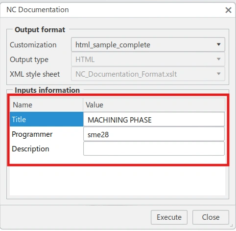

These customization key values appear as list of values to choose from when command is launched as show below
Based on selected customization key by user, the business rule sets the output type value

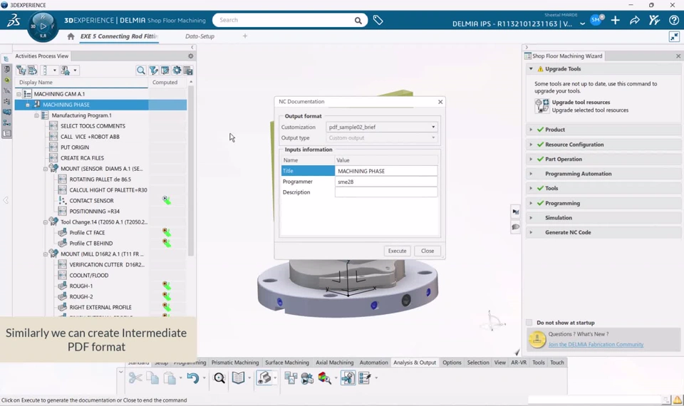

If the customization key is corresponding to PDF format, formatting XSLT is assigned accordingly. Also for custom formats second image can be added in document as custom image. For now, DELMIA logo is added as custom image.
if (sCustomKey like "pdf*")
    // Option to specifiy 2nd logo image
    let sDocumentationStartupDirectory(String)
    sDocumentationStartupDirectory = Parameters.GetAttributeString("DocumentationStartupDirectory")
    let sCustomlogo(String)
    sCustomlogo = sDocumentationStartupDirectory + "\\CustomLogo.png"
    Parameters.SetAttributeString("LogoImage2", sCustomlogo )

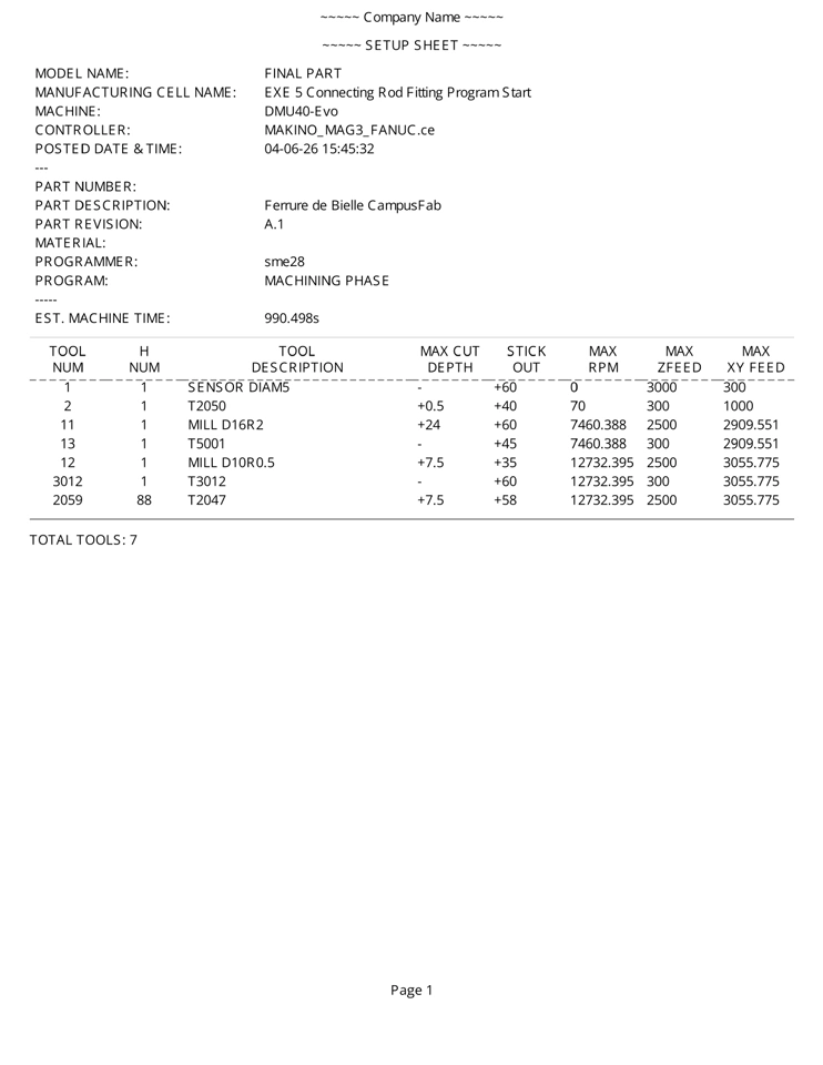

Assign name to the output NC Document.
// Custom Output File Path
    // Name of the file generated via post processing
    let sXmlFilePath(String)
    sXmlFilePath = Parameters.GetAttributeString("XmlFilePath")
    let sPdfFileName(String)
    sPdfFileName = ThisObject.Name + ".pdf"
    let sCustomOutputFilePath(String)
    sCustomOutputFilePath = ReplaceSubText(sXmlFilePath,"data.xml",sPdfFileName)
    Parameters.SetAttributeString("CustomOutputFilePath", sCustomOutputFilePath)

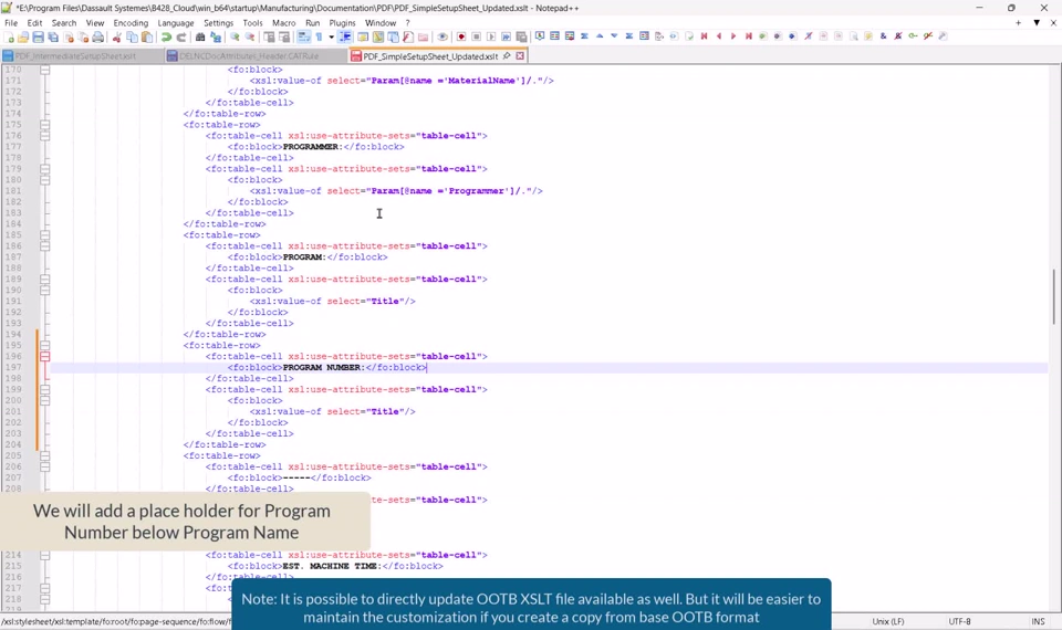

Define correct XSLT files against customization key values.
    // Custom Post Processing External Command Arguments
    // Arguments to launch executable with given inputs
    let sXsltDirectory(String)
    sXsltDirectory = sDocumentationStartupDirectory + "\\PDF\\\\"
    let sXSLTFilePath(String)
    sXSLTFilePath = ""
    if (sCustomKey like "pdf_sample_brief") sXSLTFilePath = sXsltDirectory + "PDF_Format_Sample.xsl"
    else if (sCustomKey like "pdf_sample02_brief") sXSLTFilePath = sXsltDirectory + "PDF_SimpleSetupSheet.xslt"
    else if (sCustomKey like "pdf_sample_intermediate") sXSLTFilePath = sXsltDirectory + "PDF_IntermediateSetupSheet.xslt"
    else if (sCustomKey like "pdf_sample_complete") sXSLTFilePath = sXsltDirectory DF_CompleteSetupSheet.xslt"

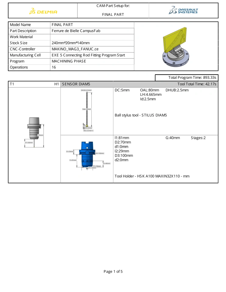

Provide argument string for external pdf converter Apache FOP.
    let sExternalCmdArgs(String)
    sExternalCmdArgs = " -xml " + "\\"" + sXmlFilePath     +"\\""
    sExternalCmdArgs = sExternalCmdArgs + " -xsl " + "\\"" + sXSLTFilePath     +"\\""
    sExternalCmdArgs = sExternalCmdArgs + " -pdf " + "\\"" + sCustomOutputFilePath +"\\""
    Parameters.SetAttributeString("CustomCmdArgs", sExternalCmdArgs)

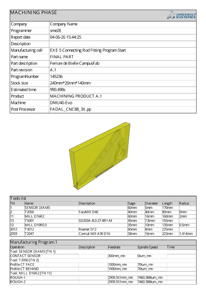

2. Business Rule for Customizing NC Documentation Content: DELNCDocumentationAttributes
During NC Documentation generation, this business rule is used to retrieve attributes to expose in NC documentation for given Mfg object either mfg program or part operation. Also it is used to define the user input values in command UI as shown below.
Below script will explain how these contents are managed by the business rule.

Retrieve Root Object and define Interactive attributes for which user can enter value in UI
let OutAttribute_Mode(List)
let OutAttribute_Name(List)
let OutAttribute_Alias(List)
let OutAttribute_Value(List)
let OutFormat(List)
let RootMfgProgram (ManufacturingActivity)
set RootMfgProgram = Parameters.GetAttributeObject("RootObject")
// Doc title
OutAttribute_Mode.Append("INTERACTIVE")
OutAttribute_Name.Append("Title")
OutAttribute_Alias.Append(BuildMessageNLS("DELNCDocumentationAttributesNLS","Title"))
OutAttribute_Value.Append(RootMfgProgram.Name)
// Programmer Name
OutAttribute_Name.Append("Programmer")
OutAttribute_Alias.Append(BuildMessageNLS("DELNCDocumentationAttributesNLS","Programmer"))
OutAttribute_Value.Append(Parameters.UserID)
// Programmer Comment
OutAttribute_Name.Append("Comment")
OutAttribute_Alias.Append(BuildMessageNLS("DELNCDocumentationAttributesNLS","Comment"))
OutAttribute_Value.Append("")

Now set image format for the image generated for mfg program. By default, only Manufacturing Product is visible in image but if the customization key is for intermediate file format, then accessories are also shown in generated image.
// Image Format
OutFormat.Append(List("showMfgProduct", true))
let sCustomKey(String)
sCustomKey = Parameters.GetAttributeString("CustomizationKey")
if (sCustomKey == "pdf_sample_intermediate") OutFormat.Append(List("showAccessories", 1))

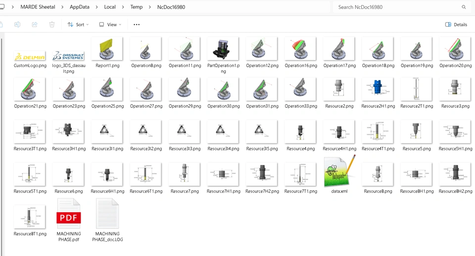

Note: All the generated data like images, output document, Data.XML etc. are stored in local folder at location shown in below image. There will be new folder created in C:\\Users\\<UserName>\\AppData\\Local\\Temp folder with name NcDocXXXXX. It is temparary folder and only available when the current session is open. Once the session is closed, this folder is deleted.
Business Rule Setup
There are two Business Rules applicable for Generation of NC Documentation.
  1. Customizing NC Documentation Options:
    1. Business Rule opening Id - DELNCDocumentation_ID:
      The Business Rule can be executed in two different ways.
      1. DataSetup App: If you create the script through DataSetup, it remains persistent in the database, is stored on the server and available to all. The script opening ID will be available under Machining Business Logic.
      2. CATRule/CATRuleExit: If you create the script using a CATRule, you must store the files DELNCDocumentation.CATRule and DELNCDocumentation.CATRuleExit in ..\\resources\\knowledge\\scripts. You can then edit the CATRule file or create a new CATRule and CATRuleExit files with an Opening ID of DELNCDocumentation_ID.
        <strong>Note: </strong>The <strong>Opening ID</strong> cannot be changed. Be careful while using this method as the setup is done on local machine and it is not available to all users. Each user will have to do the setup individually.
  2. Customizing NC Documentation Content:
    1. Business Rule opening Id - DELNCDocumentationAttributes_ID:
      2. CATRule/CATRuleExit: If you create the script using a CATRule, you must store the files DELNCDocAttributes_Header.CATRule , DELNCDocAttributes_Holder.CATRule, DELNCDocAttributes_Insert.CATRule, DELNCDocAttributes_Machine.CATRule, DELNCDocAttributes_ManufacturingOperation.CATRule, DELNCDocAttributes_PartOperation.CATRule, DELNCDocAttributes_PPInstruction.CATRule, DELNCDocAttributes_Tool.CATRule, DELNCDocAttributes_ToolAssembly.CATRule and DELNCDocumentationAttributes.CATRuleExit in ..\\resources\\knowledge\\scripts. You can then edit the CATRule file or create a new CATRule and CATRuleExit files with an Opening ID of DELNCDocumentationAttributes_ID.
How to Customize the Output NC Documentation
  • Business Rule Creation
  • Apache FOP Setup
  • Environment Variable Setup
  • How to Change CustomLogo Image
  • How to Add new User Input
Note: Similarly we can add more attributes in document which are not coming from user input by using OutAttribute_Mode.Append("CUSTOM") or OutAttribute_Mode.Append("STD") syntax.
Reference Data:
Sr.No.Customization Key ValueXSLT File Name (Documentation Folder*)Sample Output File
1html_sample_briefNC_Documentation_Lists.xslt
MACHINING PHASE.html
2html_sample_completeNC_Documentation_Format.xslt
3pdf_sample_briefPDF_Format_Sample.xsl
MACHINING PHASE.pdf
4pdf_sample02_briefPDF_SimpleSetupSheet.xslt
MACHINING PHASE.pdf
5pdf_sample_intermediatePDF_IntermediateSetupSheet.xslt
MACHINING PHASE.pdf
6pdf_sample_completePDF_CompleteSetupSheet.xslt
MACHINING PHASE.pdf
