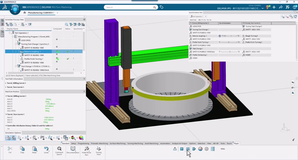

How create machine with 2 heads/turrets on the same Gantry (Y axis)?

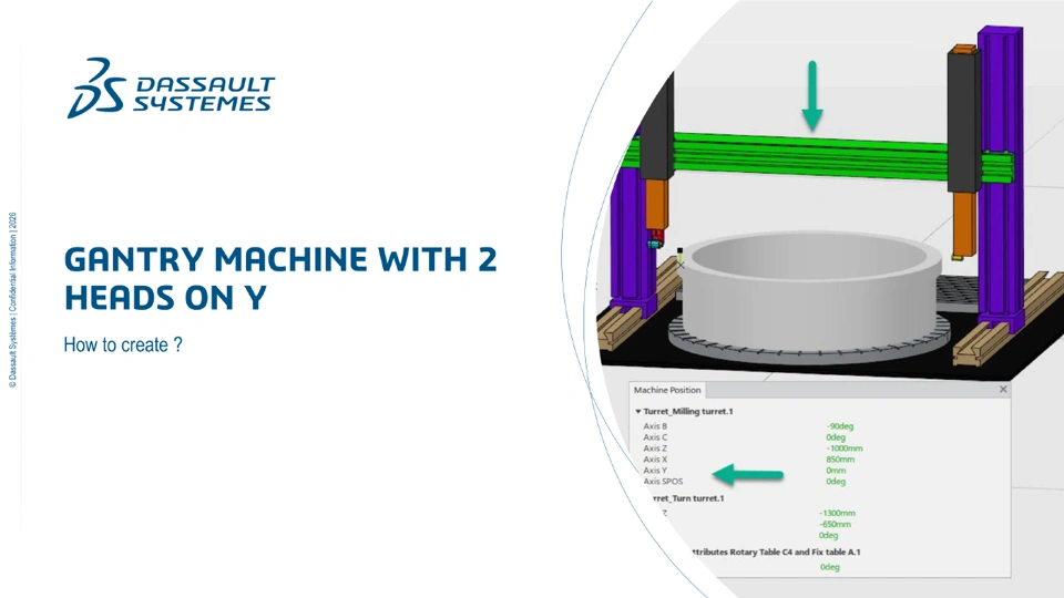

This is a specific mill-turn with common Y gantry for the two turrets.
I describe in the pdf the workflow.

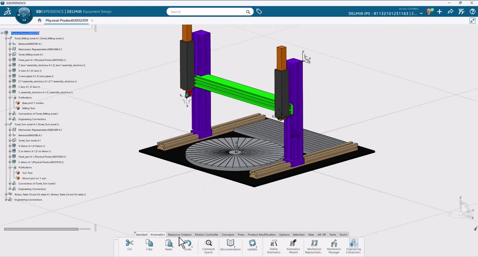

The key step is also recorded (create Engineering Connection between turret) and the 3DXML with the machine is delivered
