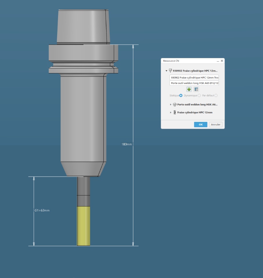

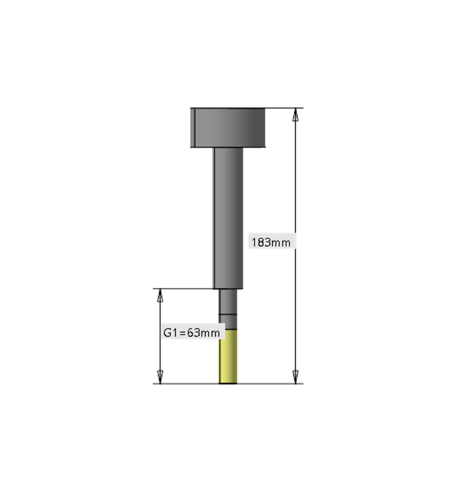

1) How could we generate automatically screenshot from real Assembly tool (With 3DRep on Holder) and not a default picture ? I don't want to define some pictures in a special folder, I d'like some pictures generated during documentation generation.
2) How could find/Generate Z minus (along Tool Axis) for each toolpath as parameter?

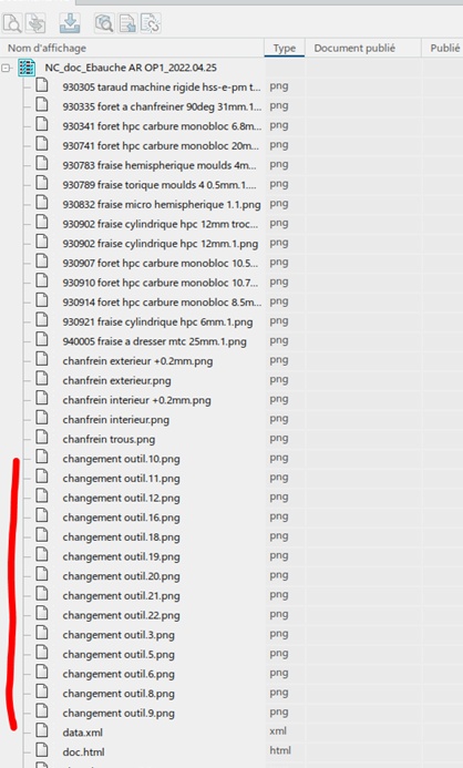

3) How could we filter screenshot generated and saved in container ? Default Screenshot about ToolChange or PP Instruction are not interesting
