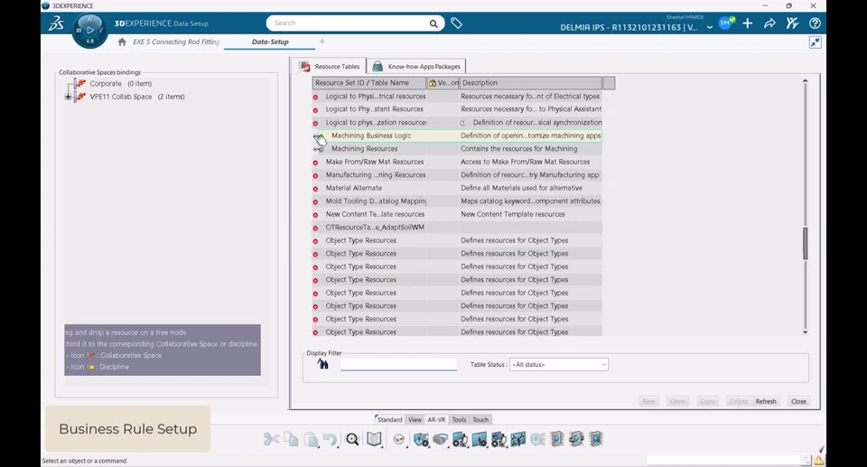

Business Rule Setup
Business Rule opening Id - DELNCDocPublication_BL_ID
The Business Rule can be executed in two different ways.
  1. DataSetup App: If you create the script through DataSetup, it remains persistent in the database, is stored on the server and available to all. The script opening ID will be available under Machining Resources.
  2. CATRule/CATRuleExit: If you create the script using a CATRule, you must store the files DELNCDocPublication.CATRule and DELNCDocPublication.CATRuleExit in ..\\resources\\knowledge\\scripts. You can then edit the CATRule file or create a new CATRule and CATRuleExit files with an Opening ID of DELNCDocPublication_BL_ID
    Note: Be careful while using this method as the setup is done on local machine and it is not available to all users. Each user will have to do the setup individually.
Important Note: If you are implementing the business rule using Data Setup method, make sure to comment out the Scripts from DELNCDocPublication.CATRule file as by default this script is uncommented and is triggered when publishing the NC file.
