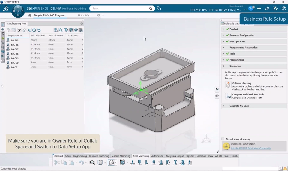

Below video demonstrates the implementation of the business rule and its effect during MAF creation for automated user attributes creation.

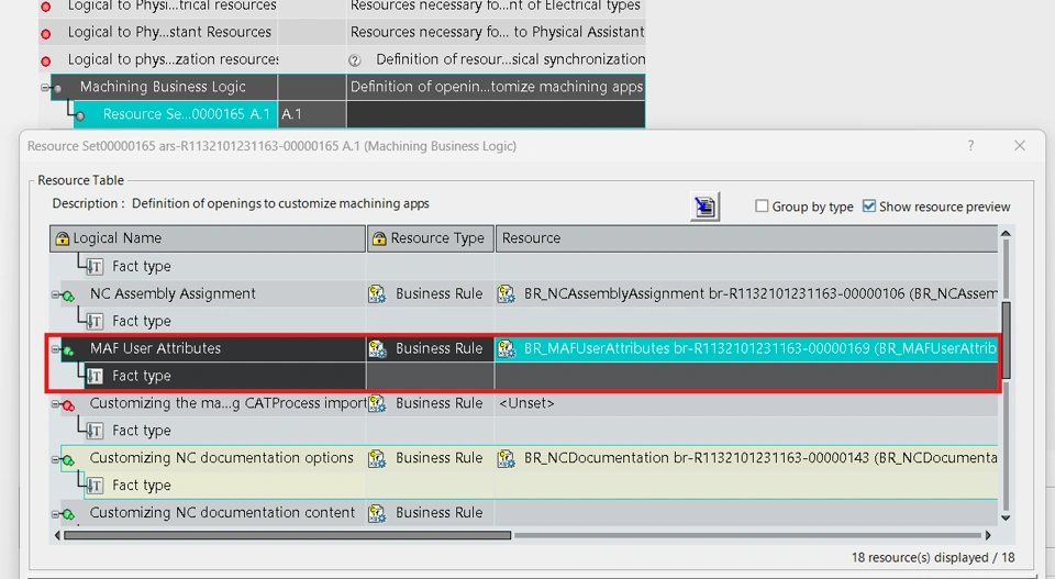

Business Rule Setup
Business Rule opening Id - DELGetMAFAttributes_ID
The Business Rule can be executed in two different ways.
  1. DataSetup App: If you create the script through DataSetup, it remains persistent in the database, is stored on the server and available to all. The script opening ID will be available under Machining Business Logic.
  2. CATRule/CATRuleExit: If you create the script using a CATRule, you must store the files DELGetMAFAttributes.CATRule and DELGetMAFAttributes.CATRuleExit in ..\\resources\\knowledge\\scripts. You can then edit the CATRule file or create a new CATRule and CATRuleExit files with an Opening ID of DELGetMAFAttributes_ID.
    <strong>Note: </strong>The <strong>Opening ID</strong> cannot be changed. Be careful while using this method as the setup is done on local machine and it is not available to all users. Each user will have to do the setup individually.
