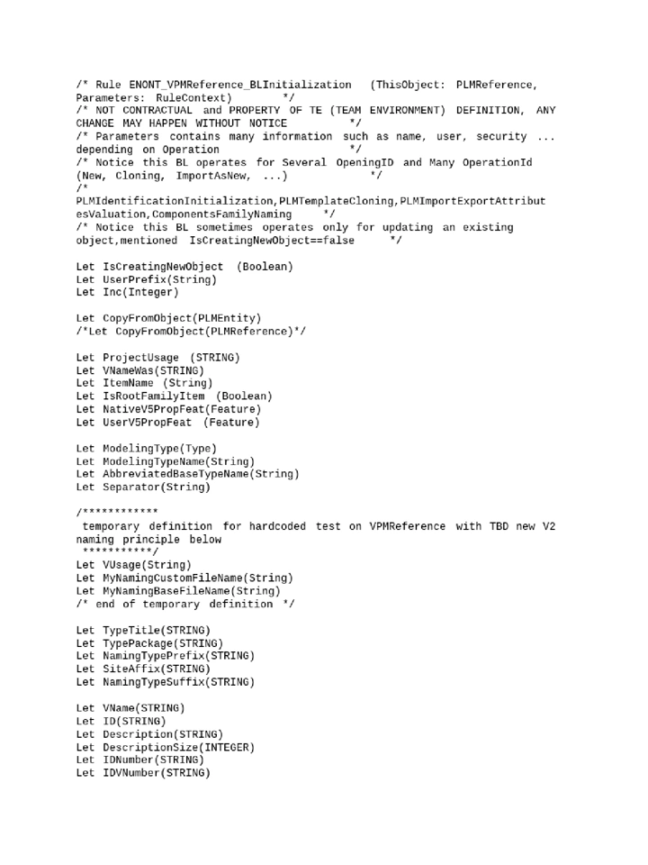

By default "ENONT_VPMReference_BLInitialization.CATRule" script is executed during FBDI Import. This business rule is operated for many use cases such as New, Duplicate, Import As New, FBDI Import etc. It manages the naming convention, generation of unique part numbers, part type allocation for every object that is created in 3DExperience platform. So we will be taking this script as base for our BL and adding the custom code for Attribute, PnO and Maturity Mapping.
/* Rule ENONT_VPMReference_BLInitialization (ThisObject: PLMReference, Parameters: RuleContext)       */
/* NOT CONTRACTUAL and PROPERTY OF TE (TEAM ENVIRONMENT) DEFINITION, ANY CHANGE MAY HAPPEN WITHOUT NOTICE         */
/* Parameters contains many information such as name, user, security ... depending on Operation                   */
/* Notice this BL operates for Several OpeningID and Many OperationId (New, Cloning, ImportAsNew, ...)            */
/* PLMIdentificationInitialization,PLMTemplateCloning,PLMImportExportAttributesValuation,ComponentsFamilyNaming   */
/* Notice this BL sometimes operates only for updating an existing object,mentioned IsCreatingNewObject==false    */
Below are details of the custom code that has been added for this demo example.

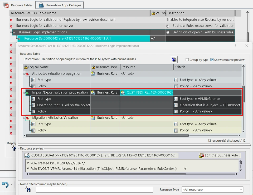

Business Rule Setup
Business Rule opening Id - PLMImportExportAttributesValuation
The Business Rule can be executed in two different ways.
  1. DataSetup App: If you create the script through DataSetup, it remains persistent in the database, is stored on the server and available to all. The script opening ID will be available under Business Logic implementations.

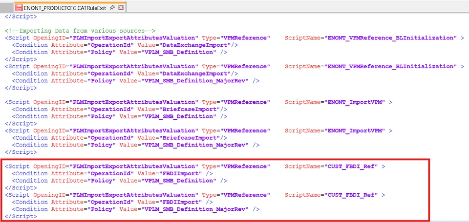

  2. CATRule/CATRuleExit: If you create the script using a CATRule, you must store the files ENONT_VPMReference_BLInitialization.CATRule and ENONT_PRODUCTCFG.CATRuleExit in ..\\resources\\knowledge\\scripts. You can then edit the CATRule file or create a new CATRule and CATRuleExit files with an Opening ID of PLMImportExportAttributesValuation.
    Note: The Opening ID cannot be changed. Be careful while using this method as the setup is done on local machine and it is not available to all users. Each user will have to do the setup individually.

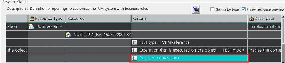

  1. Data Setup approach for BL: In this approach when creating the business rule, we have to fill out certain criteria values as shown in below image.
    If the default policy set by administrator is already known, its name can be filled in the Policy Criteria. But if it is uncertain which policy is set as default, keep this field empty to ensure that the script is executed in either case.
  2. CATRule/CATRuleExit approach for BL: In this approach, in "ENONT_PRODUCTCFG.CATRuleExit" file we have to mention the script that will be executed against "PLMImportExportAttributesValuation" opening ID. Here mention the custom script name against both entries of this opening ID if default policy is uncertain.
