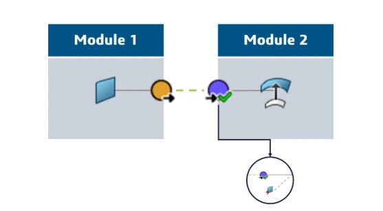

When a connection of a module breaks with an upstream module, the dependent module fails to generate. A fallback is a backup surface, plane, or parameter assigned to an input interface. When the original connection is lost, the input interface switches to the fallback automatically, while the dependent module continues to generate without interruption.

The fallback creates a backup, allowing the part to continue generating even if the original output is deleted.
As long as the link between the modules exists, construction features from Module 2 will be generated. If this connection breaks, the design of Module 2 will continue to be created.

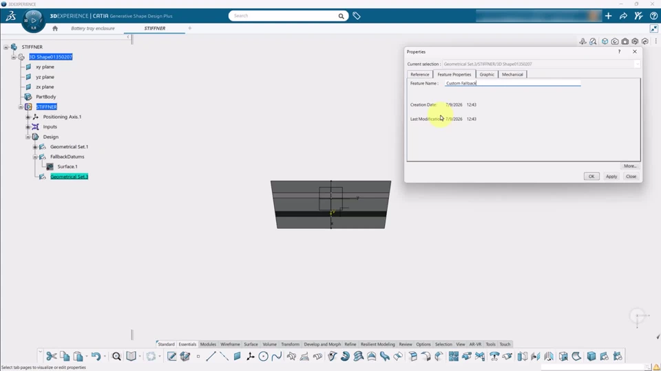

You can also customize the fallback to change the default element.

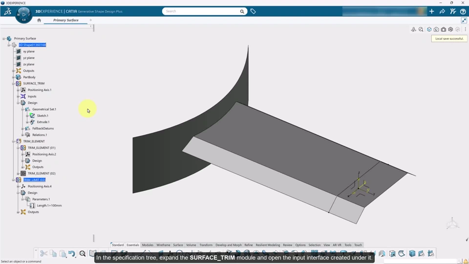

Here, with the help of Fallbacks in CATIA 3DEXPERIENCE, you can configure Automatic Fallback or define Manual Geometric and Manual Parametric Fallbacks for input interfaces. When the original output is unavailable, the input interface automatically switches to the first available compatible result or to the predefined backup geometry or parameter, ensuring downstream modules continue generating while maintaining design continuity.
Play the video to watch how to create the Automatic Fallback.
Play the video to watch how to create the Custom Fallback.
