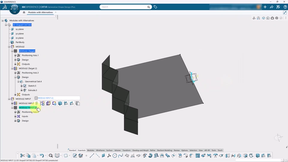

Use Case: Seamless Variant Management in Complex Designs
Scenario: During the design process, working on a complex part with repeating feature clusters can quickly become time-consuming and error-prone if managed manually. Each design change requires updating every individual instance, which often leads to inconsistencies across the model.
With the help of Module Alternatives, you can create multiple versions of a module and switch between them seamlessly, while preserving the interface relationships with other modules. This ensures that design variants remain consistent and interchangeable without disrupting the overall structure.
Play the video to watch how to create and define the Alternative Module.
