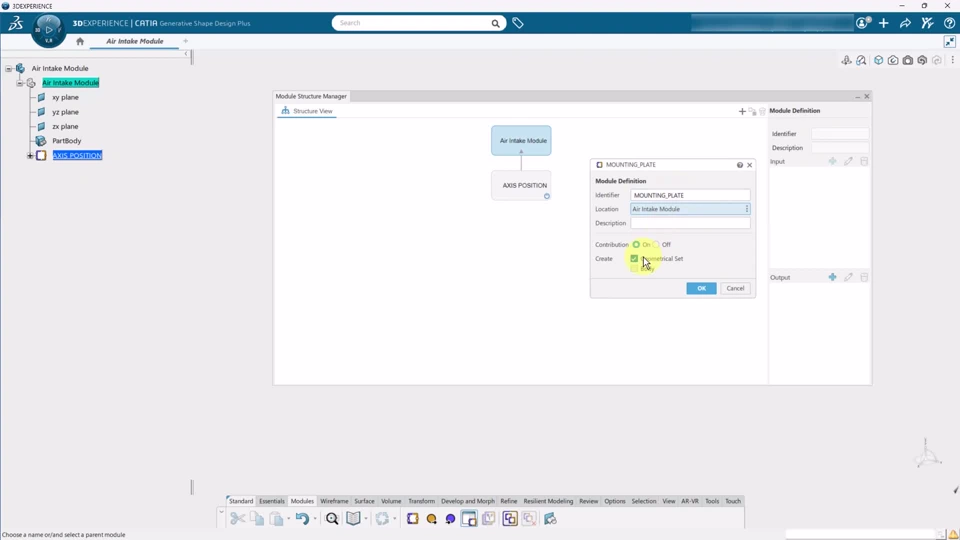

Managing Modules
  • From the Modules section of the action bar, click Module Structure Manager .
  • In the Module Structure Manager dialog box, in the Module identifier, specify a name for the module.
    When you rename a module, all the connected interfaces are renamed automatically to preserve the connection. To disconnect the interfaces, clear Keep interfaces connected.
  • To create a submodule under the selected module, do one of the following:
    • Select a module, click , and rename it if required.
    • Select a module in the tree, and from the shortcut toolbar, click Create Child Module .
      Click in the structural view to turn on or turn off a module.
  • To change the contribution state of the module, do the following:
    • To turn off the module and set it as not contributing, select the active module in the tree, and from the shortcut toolbar, click Switch off .
    • To turn on the module and set it as contributor, select the inactive module in the tree, and from the shortcut toolbar, click Switch on .
    • Click to delete the selected module.

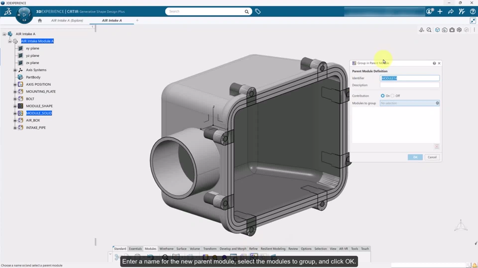

Grouping Modules
  • You can do this when you need to regroup the modules or create a new intermediate module between the selected sibling modules and their parent module.
  • From the Modules section of the action bar, click Group in Parent Module .
  • In the tree, select one or more modules that you want to group.
    The select modules are listed in the Modules to group.
