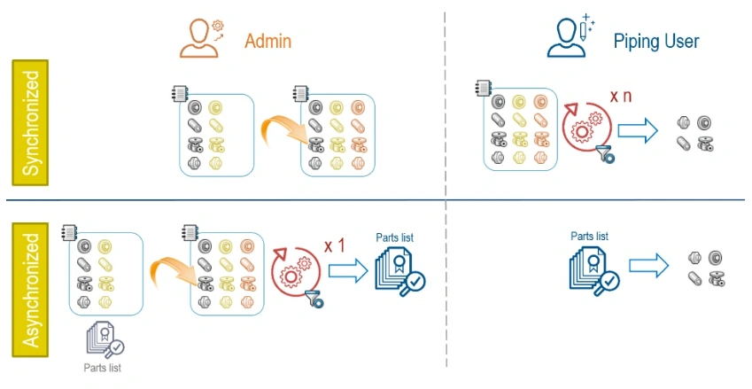

Use Asynchronized Filter
“Formula Asynchronized” mode is only created for performance reasons.
PLM parts are computed at a given point in time « T » based on the unit filter formula & database  content (result) and the result is stored at unit filter level as a not editable list of PLM parts been a photo at « T »,
When the returned parts for this filter will be requested by application, the stored list of the parts with the Unit Filter will be returned.
Warning: if parts are added to catalog, filter result have to be recomputed manually
Documentation about Asynchronized Filter :
Creating or Editing Filter Units
 https://help.3ds.com/2021x/english/dsdoc/eseusermap/ese-t-filter-unitedit.htm?contextscope=onpremise
Note : since 19xFD02, Asynchrone mode is integrated inside Fluidic cache (System will load only part from the Spec)
