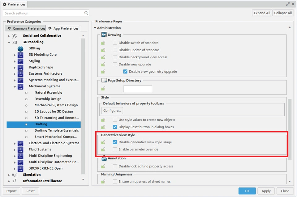

- View Update Rule (VUR) has almost trivial impact on performance
- Generally try to set up graphical representation via GVS and just supplement annotations via VUR

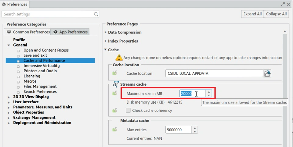

Stream Cache
Recommended Value : 20 000MB

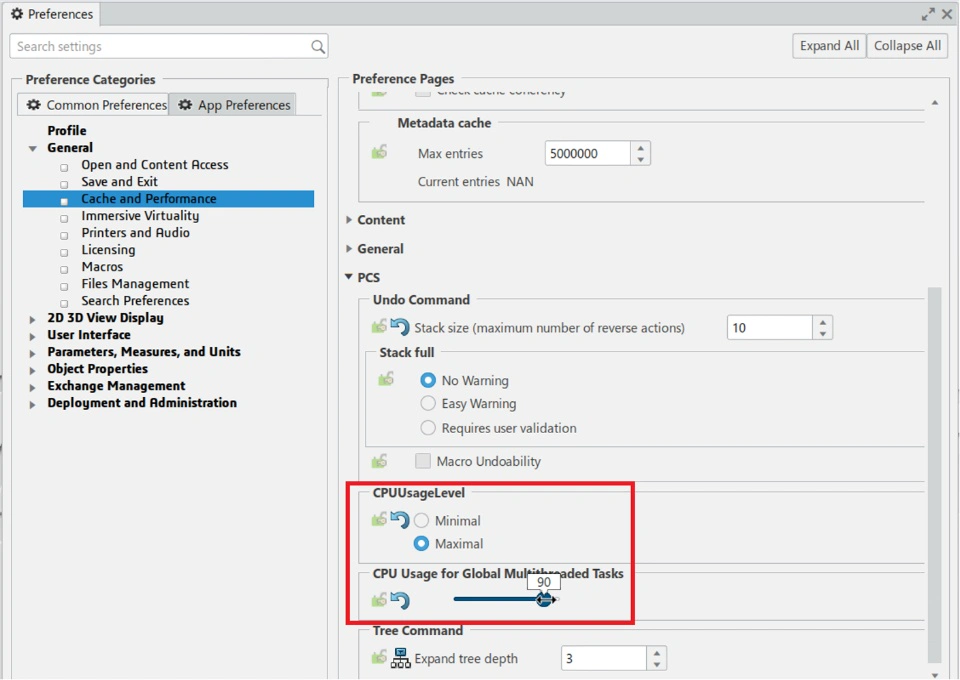

CPU Usage
- CPUUSageLevel : Maximal
- CPU Usage for Global Multithreaded task : 90%

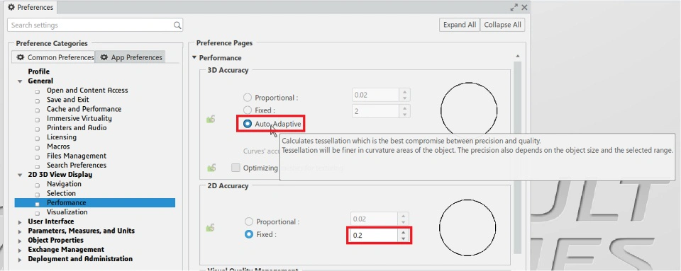

Using fixed 0.2mm 2D accuracy from MW,

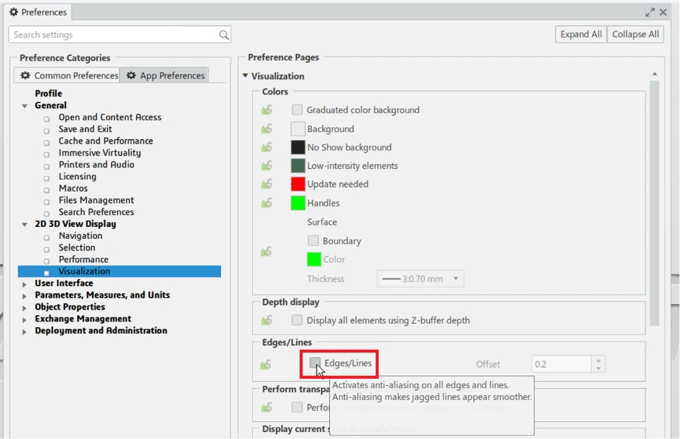

Disable Anti-aliasing

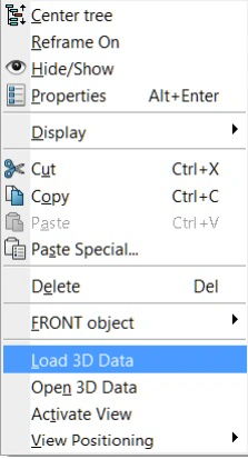

Load 3D data instead of Opening for Update
In case you need to perform an Update on existing Drawing you can use Load 3D Data command by right clicking on the Drawing . it will consume less memory and it is quicker then opening 3D data.

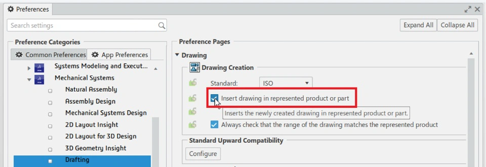

Enable/Disable to save the drawing in the 3D Model tree

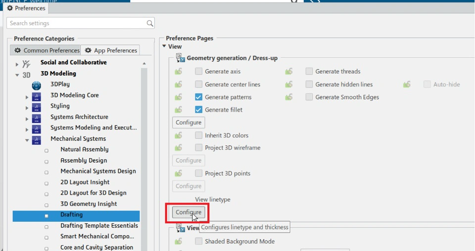

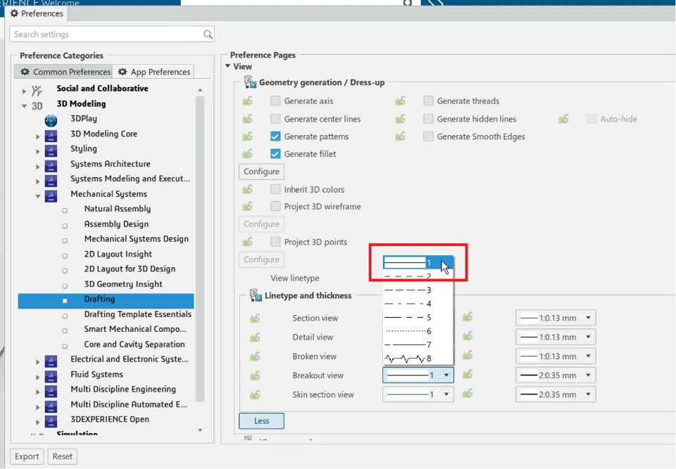

Change Linetype for Breakout view
Note: for this option to be available first make sure that GVS is disable

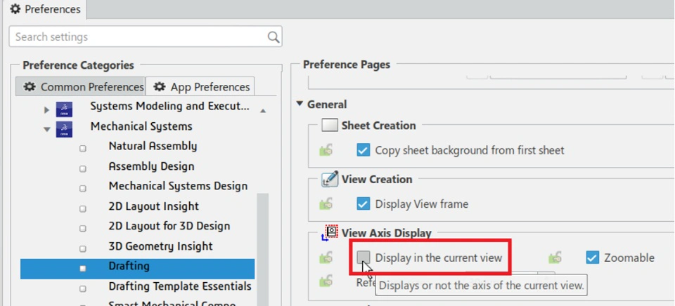

Disable Axis in drawing (avoid extended Frame View to the origin of the model)

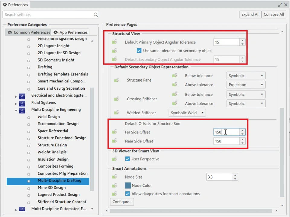

Default Structural Box Preferences for Structural View
Following Preferences allow you to define the size of the yellow Structural Box used when creating a Structural View.
