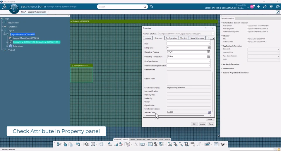

In the follwing video :
  • we add a new attribute Services Code on Piping LineID object
  • we check the attribute in property panel
