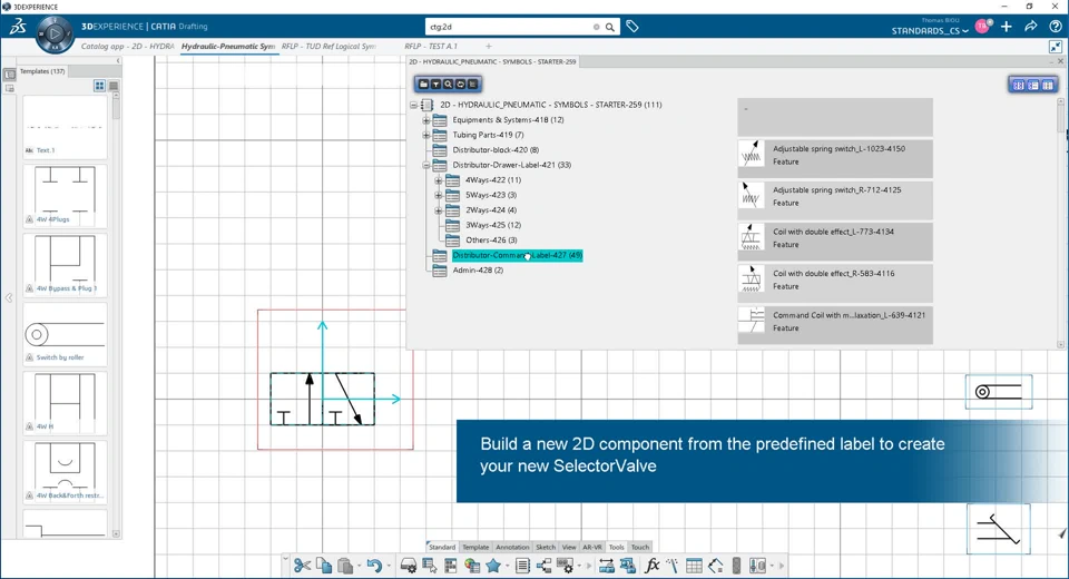

Create a Selector valve based on Standard component for Valve type + Label for the inner block details and the drivers

2024 : You can't enrich your symbol by using a 2D drawing component stored into a catalog, it is why we have used here labels . but if you decide to not use catalog and you open the Drawing that contains your symbols, then you can use similar scenraio without Label from drawing document.
Note : BI essential is not colloring the labels --> it can be an issue
