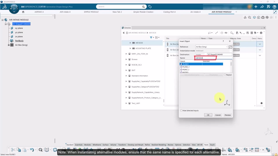

When a module is saved to a Library, its input and output interfaces are preserved exactly as defined. When that module is instantiated from the library into new 3DSPACE, the interfaces automatically adapt to the new context resolving references, parameters, and geometry without any manual modification. The module's internal features update themselves to the new context through the interface contract, making reuse seamless across any project that retrieves it.
Saving a module in a library in CATIA 3DEXPERIENCE stores a fully defined module along with its complete input and output interfaces in a governed, searchable team repository. These defined interfaces act as a contract, ensuring all geometric references and parameters remain intact.
When instantiated in a new assembly, the module’s interfaces automatically adapt to the new context. Its internal features resolve seamlessly without requiring manual modification, ensuring consistent and immediate reuse across projects.

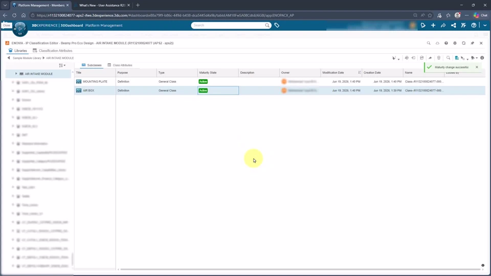

For Editing the Libraries, you also need Classification Manager Role.

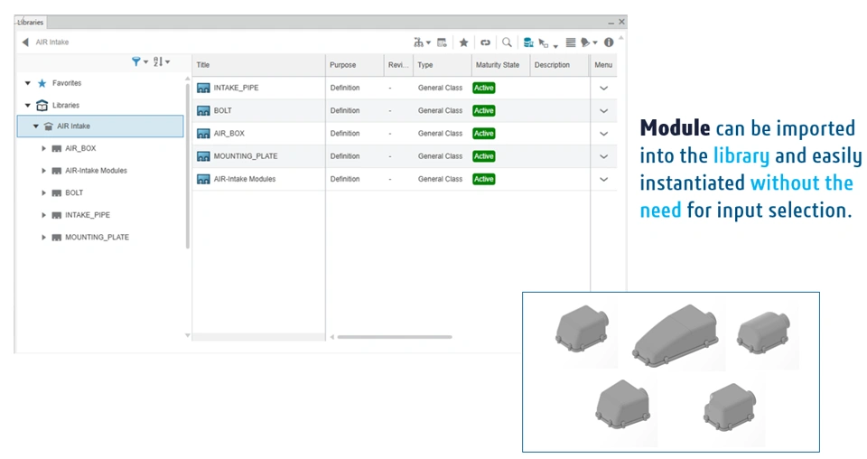

Library:
A governed repository within CATIA 3DEXPERIENCE where fully defined modules are stored alongside their complete input and output interfaces, making them searchable for team-wide reuse.
When a module is saved to the library, its interface contract including all named inputs, outputs, and internal feature definitions are preserved exactly as built. Any team member can search for the module by name or classification, retrieve it, and instantiate it into a new assembly without needing to understand its internal construction.

Play the video to watch how to instantiate modules in a new 3D Part.
