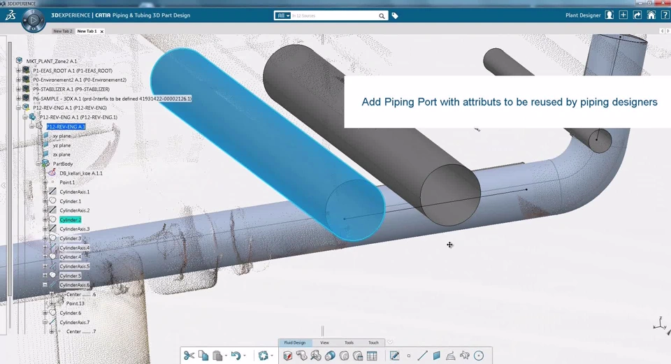

Need to receate Piping 3D Network from Cloud of Point
It is very difficult to recreate automatically a fully intelligent 3D Piping model with all the Specification from a cloud of Point
Cloud of point are usually not containing the object Meta data whereas these informations are critical to recreate a good quality digital twin that doesn't contains only the 3D geometry but also the system specification (Material Class, standard dimensions ....)
Let's see the capability that offer 3DExperience CATIA
Video - Assisted Method
Old video
The first level of answer is to assist the designer in recreating the piping network by automatically recognizing the canonic cylinder shapes
