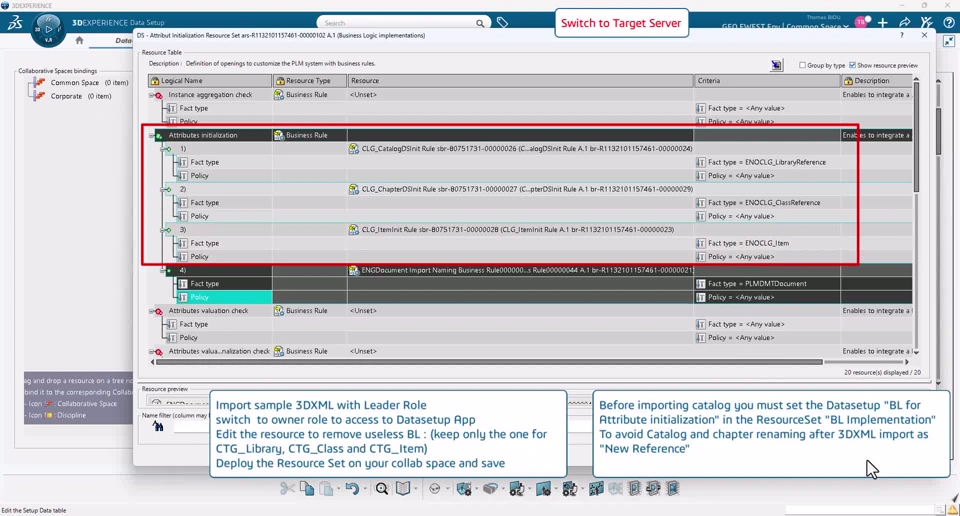

Objective is to reroute link beetween engineering Part filters and Catalog chapters. It can be to
  • repair broken links
  • reroute to a new catalog
Different possible usecases:
  • you want to import as new in the server in 2 step (2 different 3DXML) a Piping Setup composed of a Piping engineering specifications and a Piping Part Catalog   so the link between part filter and catalog will be broken
  • you want to duplicate a piping specification and part filters and to reroute the links to a new catalog
  • you want to migrate from catalog to library (not yet adressed here - to come)
